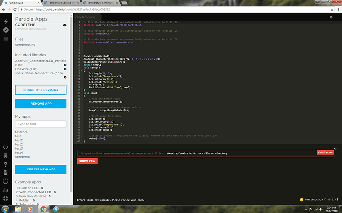

HI Sam
I am having some problems compiling the temperature sensing project as been discussed in this forum.
When I compile the code I get the message
lib/spark-dallas-temperature/spark-dallas-temperature.h:27:36: …/OneWire/OneWire.h: No such file or directory
This morning I was talking to Graham and thinks it could a configuration issue of my Web IDE.
I have also complied the project on desktop IDE with the same result.
Attached is a screenshot of my code , does it look OK?
