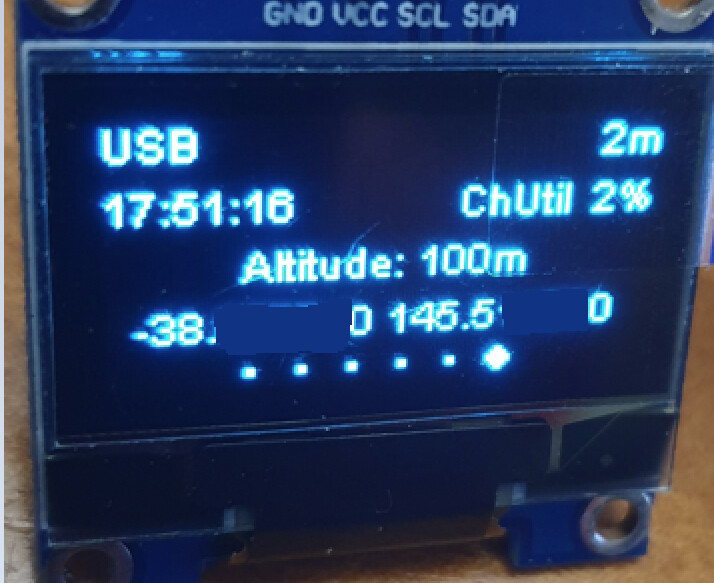

Ian, with that test firmware these are my screen shots
Last “tab/screen” when GPS is ok and working.
So a valid Altitude and location data.

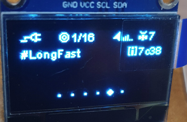

2nd last screen
No error about the gps and the 7 Satellites icon

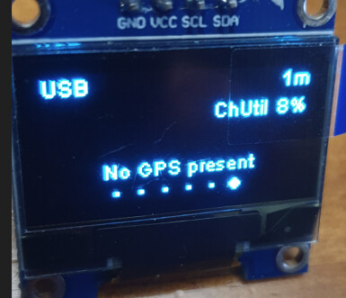

Then when I booted and no gps was connected.
that last screen should showed a “No GPS” message
And the same for the 2nd last screen.
I just did a re flash to triple check.
