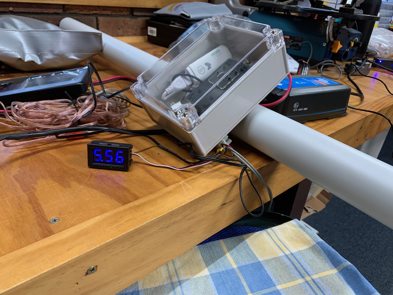

Plenty of options to consider. I’ll go with using some clear glass and moving the Pi closer to the glass. Here is a shot of the setup (excuse messy workbench).

Shouldn’t be too hard to glue a glass panel to that. Move the camera right up to the glass and it will be a bit more forgiving when it gets a bit grubby.
When using materials in that sort of environment be careful of the Sun. Can be surprisingly destructive when it sets its mind to be so. I would question that perspex lid. How long has it been in situ now. Might be OK, you would have to look up the specs on the box. If it is likely to damage you could go with a non clear lid on an outdoor rated box and cut a hole in that for the glass.
Anything you use here should be able to withstand full sunlight or you will find yourself re building in a few months. Old Sol can be pretty savage.
If you are using any cable ties they need to be black.

Hi George,
Looks great. A messy workbench shows you’ve been hard at work.
To follow the fisheye lens discussion, a glass or plastic dome could also be good to avoid the corners of the box.
I am not familiar with how the lens works but thinking about why the lens has the range it does, Its not taking square photos most of the time so it doesn’t need to be a 180 degree range in both axes. There may be a better reason but that’s how I think of it.

The weather station has been in place since Sept 2021. The case I bought from Core as an “weatherproof box”. I’m going to order another Pi Zero and work on installing new weather software on that. I’ll also experiment with the camera, lenses and the suggestions made here.
