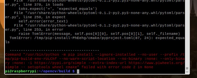

Hey Tim, When running “pip install face-recognition --no-cache-dir” I get this error
Can you help? Thanks!
Using cached https://files.pythonhosted.org/packages/3b/45/5e3320d2d0b399908a97824581bb52fbbc0d71b21c4f184932d58c6bf18a/cmake-3.27.7.tar.gz
Exception:
Traceback (most recent call last):
File “/usr/lib/python2.7/dist-packages/pip/_internal/cli/base_command.py”, line 143, in main
status = self.run(options, args)
File “/usr/lib/python2.7/dist-packages/pip/_internal/commands/install.py”, line 338, in run
resolver.resolve(requirement_set)
File “/usr/lib/python2.7/dist-packages/pip/_internal/resolve.py”, line 102, in resolve
self._resolve_one(requirement_set, req)
File “/usr/lib/python2.7/dist-packages/pip/_internal/resolve.py”, line 256, in _resolve_one
abstract_dist = self._get_abstract_dist_for(req_to_install)
File “/usr/lib/python2.7/dist-packages/pip/_internal/resolve.py”, line 209, in _get_abstract_dist_for
self.require_hashes
File “/usr/lib/python2.7/dist-packages/pip/_internal/operations/prepare.py”, line 298, in prepare_linked_requirement
abstract_dist.prep_for_dist(finder, self.build_isolation)
File “/usr/lib/python2.7/dist-packages/pip/_internal/operations/prepare.py”, line 100, in prep_for_dist
self.req.load_pyproject_toml()
File “/usr/lib/python2.7/dist-packages/pip/_internal/req/req_install.py”, line 428, in load_pyproject_toml
str(self)
File “/usr/lib/python2.7/dist-packages/pip/_internal/pyproject.py”, line 43, in load_pyproject_toml
pp_toml = pytoml.load(f)
File “/usr/share/python-wheels/pytoml-0.1.2-py2.py3-none-any.whl/pytoml/parser.py”, line 303, in load
filename=fin.name)
File “/usr/share/python-wheels/pytoml-0.1.2-py2.py3-none-any.whl/pytoml/parser.py”, line 370, in loads
toks.expect(‘=’, ‘expected_equals’)
File “/usr/share/python-wheels/pytoml-0.1.2-py2.py3-none-any.whl/pytoml/parser.py”, line 250, in expect
self.error(error_text)
File “/usr/share/python-wheels/pytoml-0.1.2-py2.py3-none-any.whl/pytoml/parser.py”, line 253, in error
raise TomlError(message, self.pos[0][0], self.pos[0][1], self._filename)
TomlError: /tmp/pip-install-gDsE2R/cmake/pyproject.toml(87, 24): expected_equals
