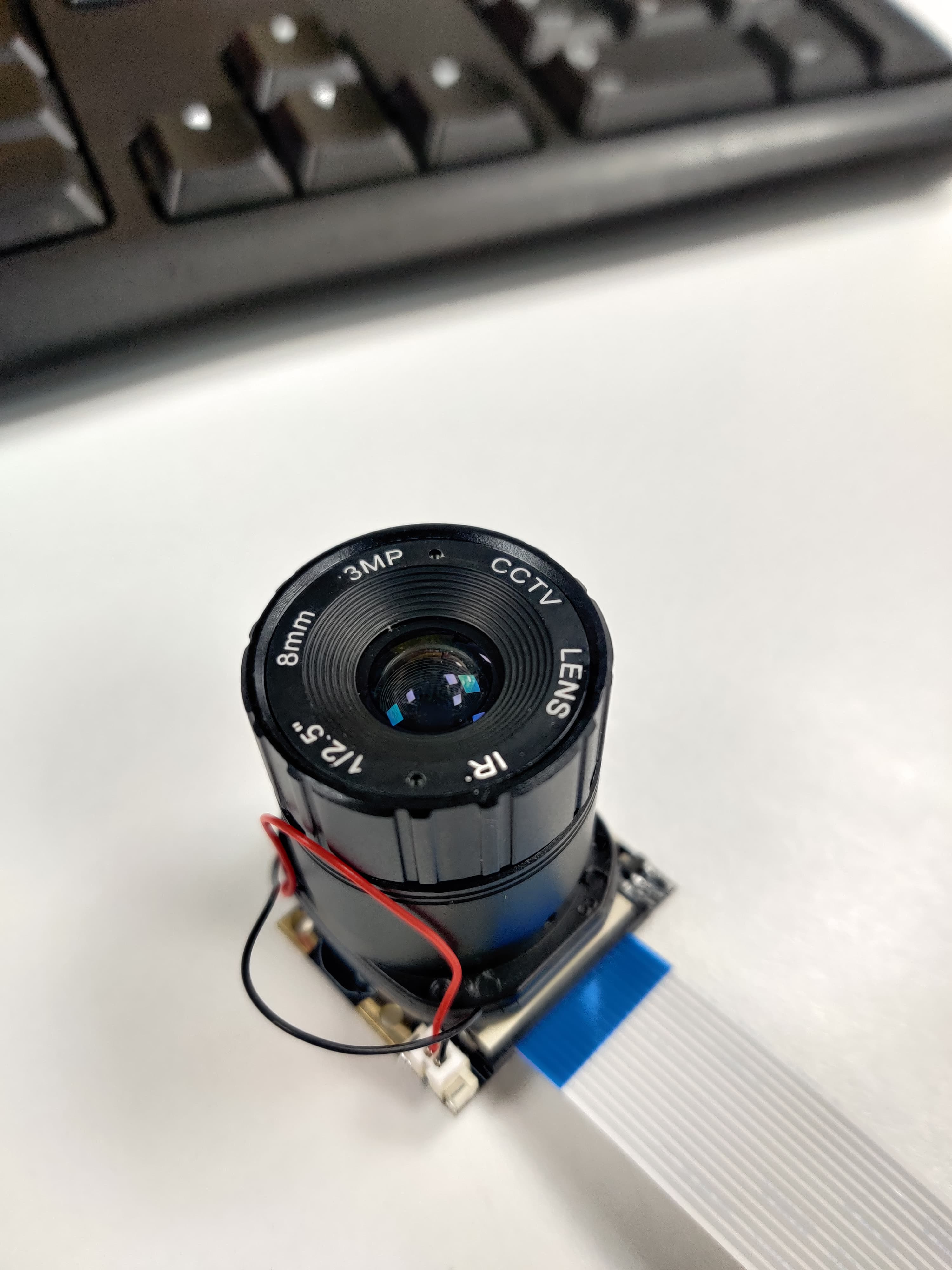

Hey, Sorry I sent this to the wrong forum this was for the “hand recognition and finger recognition” page.
The camera works as normal when I take a picture or a video using the terminal commands or when using basic python code to see the camera in thonny ide, but it just goes purple and laggy when I use the scripts in the video. I switched to a raspberry pi v2 camera and it worked first time.
This is that camera that doesn’t work properly with the scripts
Hey mate, I had a feeling it was in the wrong place but that’s all good :slight_smile:.
It must be due to different drivers running inside each of these cameras. It may be possible to run the same driver on the above camera that the Raspberry Pi V2 camera has. The Raspberry Pi V2 Camera used the V4L2 driver. Have a look here to see how to install this driver.
I haven’t used your above camera so can’t know for sure whether that will work, but seems worthy of a go.
