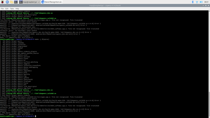

I was running the make -j $(nproc)command in the terminal and it was working just fine, though, at about 25%, it gave me an error, the same one you mentioned above, but when I retyped the command, it still gave me an error. I tried it 2 times but it didn’t work.
Please let me know what to do asap. Thanks!
(A picture is attached below)
Hey mate,
It is weird that it is doing it that often, I’d be tempted (and recommend to you) to keep running that | make -j $(nproc) | command a couple more times and see if you get any further progress. It does seem to be completing different tasks between the first 25% Stop and the second 25% Stop.
Potentially a heatsink ontop of the Raspberry Pi will help, the Pi has to do a lot of computations at this step. Also just going to ask for confirmation that you are running the previous (legacy) Raspberry Pi OS ‘Buster’.
I have tried running the command multiple times and even tried it without -j and just make but that still crashed at 30%. I am running the previous ‘Buster’ OS. Turns out the SD card files may have been corrupted and now the whole SD Card is corrupted and its in a RAW filesystem. I even tried to format it and used different third-party programs to fix it but it looks like it’s done. I’m gonna have to try to use a different SD card and hopefully that goes well. But thanks for the assistance!

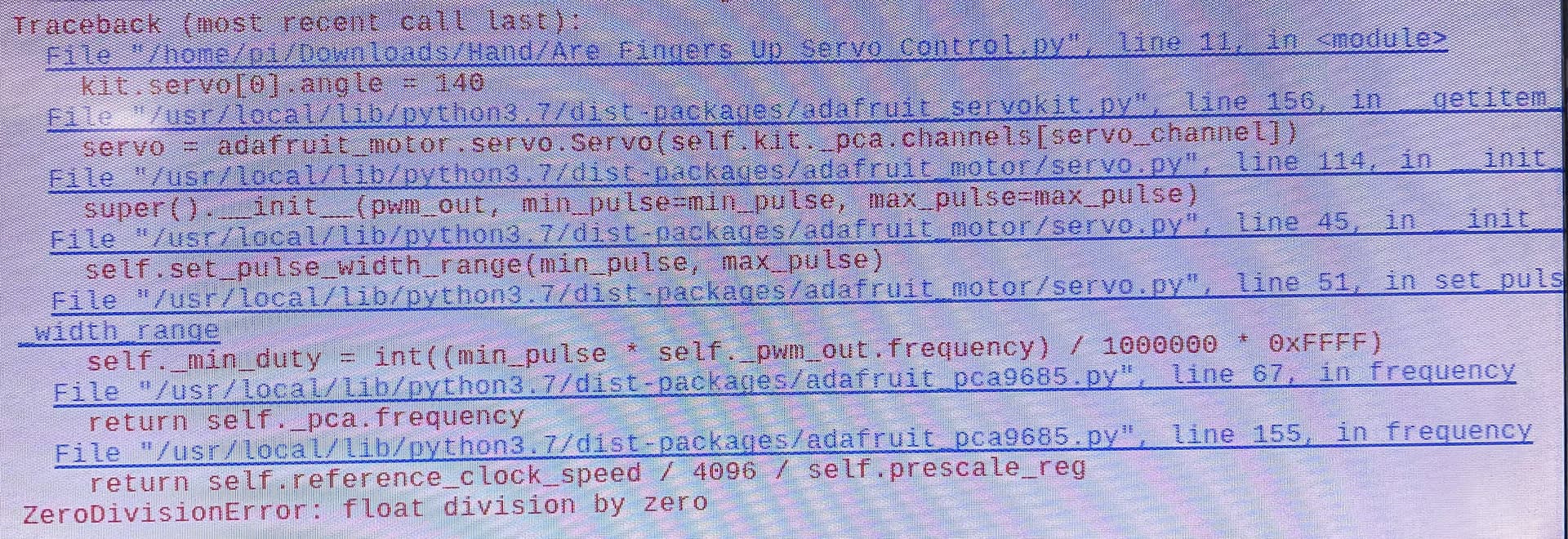

Can you share your servo code with us? 3 Backticks (```) on either side of your servo code will format it nicely on this forum.
Keen to get to the bottom of this with you!
-James
Hey Shirley.
I reckon what is going on is I wrote that Code for an Adafruit Servo HAT in mind, like in this guide, whereas all you desire is a single servo to be controlled, like in this guide.
If you take the Code from that second linked article and combine it with the Python scripts in this article you’ll get the result your looking for :slight_smile:. I’ll clear up any future confusion by renaming that file slightly as well.

[Question repost for reference only] Hi Tim, thank you for the guides. I was trying to run the ’ Are Fingers Up Servo Control.py’ and a SG90 servo motor was connected to pin7, 5V of my Rpi. However, I have encountered the below error:
