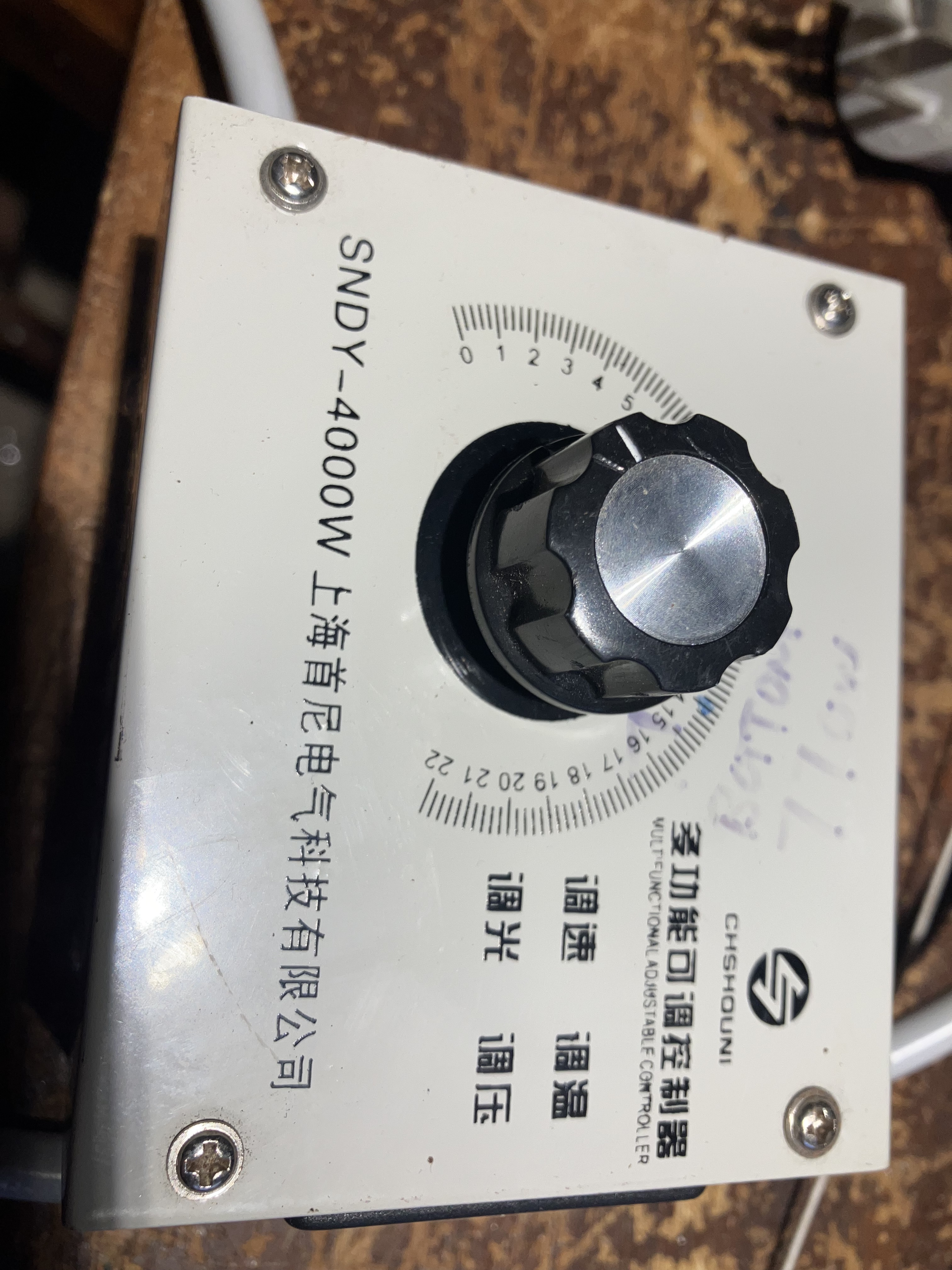

I am considering ditching the low power route and just use the toaster oven element with 240V mains power and a potentiometer to moderate the element output down to something more suitable for low temp heating.

NO, very dangerous. The potentiometer could flash over and explode unless it has been designed for the job. Reducing mains power usually involves some phase switching, leading or lagging. Like a fan speed or light dimmer control. A potentiometer is usually used to control other switching methods.
If you want to try the toaster element you could use a “Variac” to get into the right ball park. But be careful, a Variac is an Auto Transformer and does not isolate the mains. But you can usually adjust the output voltage from above 240 to quite a low value smoothly. I could not find a Variac on Core site but if you want to have a look at what one looks like Jaycar stock one Cat no MP3080. I actually have one of these.

Yes, that certainly will do the job. It was a bit confusing as this device is not a “potentiometer”
It is a large light dimmer or fan speed controller which works a bit differently. This works by “cutting off” a part of the sine wave progressively allowing the remainder through. This progressively reduces the RMS or Heating power value which is what you are interested in. The resultant wave form is like the original sine wave with bits chopped out of the leading or trailing slope so varying the RMS (heating power) value which suits your application.
The Variac on the other hand is a “variable” transformer which will retain the sine wave shape. But like the Variac I don’t think this device will isolate the 240V mains so take the same care.
This device is suited to heater elements, light dimming, fan speed etc where the shape of the sine wave does not really matter but should not be used for applications where the sine wave is important
