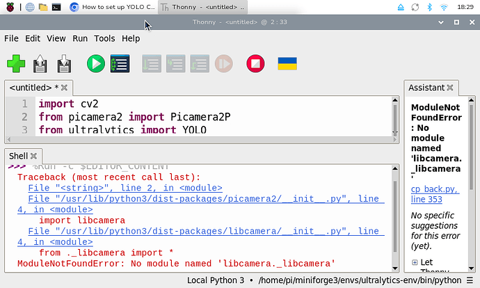

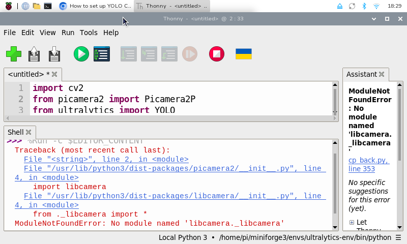

Has this been resolved? I am seeing the same thing. Thonny returns the error message:
%Run -c $EDITOR_CONTENT
Traceback (most recent call last):
File “”, line 2, in
File “/usr/lib/python3/dist-packages/picamera2/init.py”, line 4, in
import libcamera
File “/usr/lib/python3/dist-packages/libcamera/init.py”, line 4, in
from ._libcamera import *
ModuleNotFoundError: No module named ‘libcamera._libcamera’
I am at the end of the tutorial, where I test the sample code. I have tried reinstalling everything twice, line by line, I have also reinstalled the whole Raspberry OS. I have tried plugging in the camera in the other port (I use Pi 5). Please anyone help with this error.
@David55659 @Pavel312670,
We found the issue to be that this guide only works on Bookworm OS. Trixie OS is the new default version, so you will need to reflash your Pi with Bookworm which will be one of the legacy 64-bit OS options.
Hope this helps!

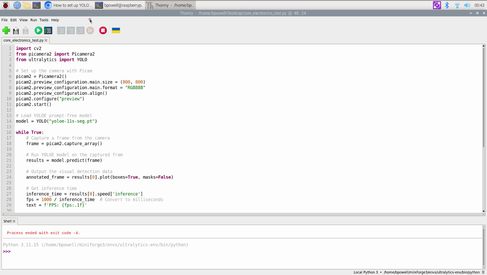

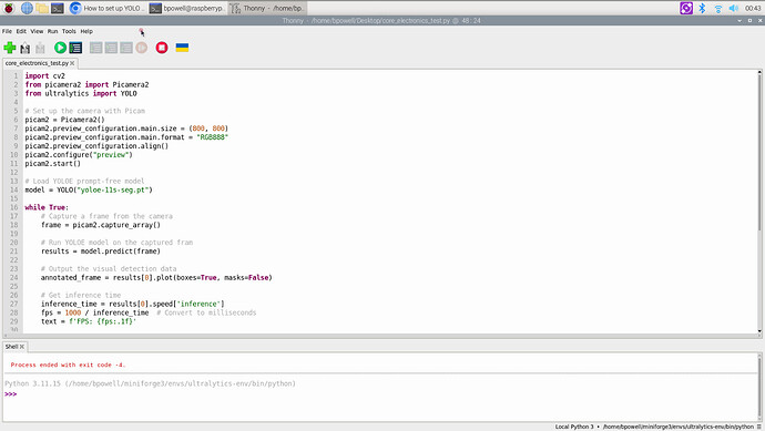

Hi, @Jaryd. I am a student trying to use this guide to download YOLO so that I can use it for a project. I have minimal experience with raspberry pi and python coding. I have followed all of these steps, including the comments. I am now receiving this “Process ended with exit code -4” without the camera ever turning on. Any suggestions would be greatly appreciated.
Hey there, @Bryce315983,
Exit Code -4 is a generic error that could cover a lot of potential situations. So we can get a better idea of what could be going on in your system, could you please return the output of the following:
For Bash:
cat /etc/os-release
In addition, so we can rule out this be an issue with Thonny, could you please run this code from Bash from your venv and let us know if you receive the same error.
@Jane
Thank you for the response. I have attached screenshots with the error messages received. I am on a Raspberry Pi 4 Model B if that helps at all.
Screenshot 2026-03-30 001313
Well that’s a new one.
‘Illegal Instruction’ is not an error with the Python script, its a bash error, and one that is maddeningly generic. It usually means that the CPU was given a task that it is incapable of doing, hence it being ‘Illegal’.
May I ask exactly what model of Raspberry Pi 4 that you are using?
