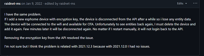

How close is this to your issue ?
Note the comment is to remove the API: encryption key
I haven’t actually set or changed any encryption keys manually, only the WiFi password, so I’m trying to work out what, if anything, is set where.

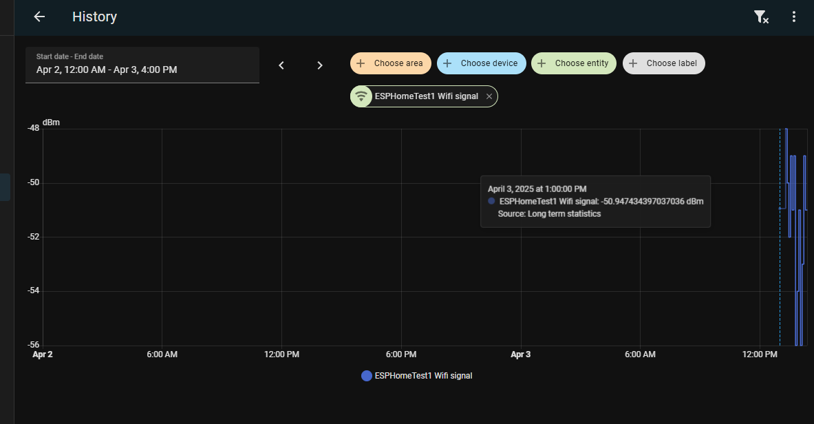

  4. If you want to see status over time you should add sensors, such as the wifi_signal sensor. It was one of the first I added when I started with my ESP01, and I include it as standard in all my devices now (though I update it much less frequently now that I am confident with the wi-fi signal).
sensor:
  - platform: wifi_signal
    update_interval: 5 min

That little code snippet for the wifi monitor worked perfect first time. So just for testing purposes, I have an ESP32 C3 with that wifi monitor running, so far with out any issues.

It took a bit of fiddling to find versions and platform versions that worked. The ESP32 C6 has been working for about 3 weeks now with no hiccup.
Given the similarity of code, I was actually thinking it’s not a ESPHome thing, more likely something different with the hardware - the C6 is more advanced than the C3, but I’m only using basic WiFi. Hence, I am still looking through WiFi settings as Michael had a few good suggestions in that space, it could still be an encryption issue with the different chipset.
I can get logs over WiFi from the C3 but it remains online but unavailable.
If you can spot anything there, I’d love to hear it.
Thanks and cheers, Dave
