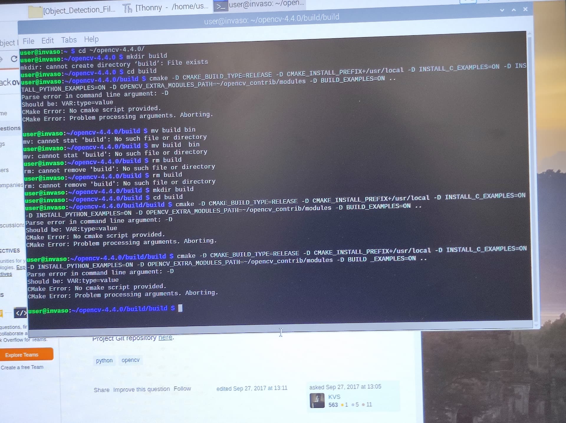

Does anyone know how to fix this Error:
pi@raspberrypi:~/opencv-4.4.0/build $ cmake -D CMAKE_BUILD_TYPE=RELEASE \
CMake Warning:
No source or binary directory provided. Both will be assumed to be the
same as the current working directory, but note that this warning will
become a fatal error in future CMake releases.
CMake Error: The source directory “/home/pi/opencv-4.4.0/build” does not appear to contain CMakeLists.txt.
Specify --help for usage, or press the help button on the CMake GUI.
Im facing a lot of trouble with this
Hi @Ishanth263430
Welcome to the forums.
With opencv there is this finiky step where you need to rememeber to make a build folder.
cd ~/opencv_build/opencv
mkdir build && cd build
That’s where PATH finds CMakeLists.txt.
I always forget this step.
Every single time I try to install openCV I have to google it and I always find this exact same stackoverflow thread. Every… single… time… :man_facepalming:
Even answering this question, I had to google it to remind myself of the solution.
Pix :heavy_heart_exclamation:
