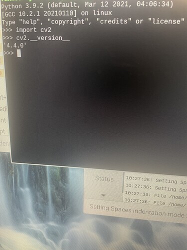

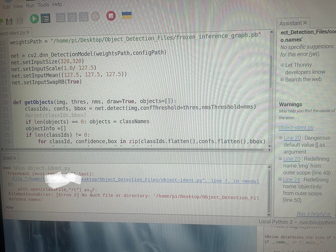

Hi, First of all thanks for uploading this master piece of machine learning . I followed every step that you provided on website but still I am getting this kind of error which I am not sure how to solve. Any help will be great.
Hi I hope you doing well. I followed every step You mention on this page and still I am getting some kind of error. Please will You be able to look at this for me. I am doing my university project. I have posted a comment today with a picture of an error.
Hey Afnan,
Thanks for your very kind words !
Just want to double-check two things. Are you using the older ‘Buster’ Version of Raspberry Pi OS or the Newer ‘Bullseye’ Raspberry Pi OS one? For this guide, we must use the Buster Version.
Also what camera module do you have attached to your system? Could you send through an image of your hardware as it is currently hooked up?
Kindest regards,
Tim
