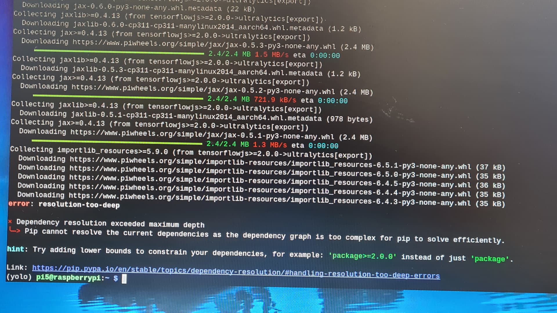

I bought a Pi5 to try to get started with YOLO object detection as explained in Core’s tutorial. When loading the ultralytics package it gets stuck with an error message detailed in the image. I have repeated the pip install ultralytics[export] command several times, but the installation gets stuck again at the same place with the same error message.
. Is there an easy solution because I have no idea how to add lower bounds to constrain dependencies?

We have a forum topic for that video exploring it, but the fix is to instead use this line here:
pip install ultralytics==8.3.100
Recent Ultralytics updates to the package have broken it, and until its fixed it will keep giving the “Dependency resolution exceeded maximum depth” error. This line installs a version from a few months ago but should work fine with what’s explored in the video.

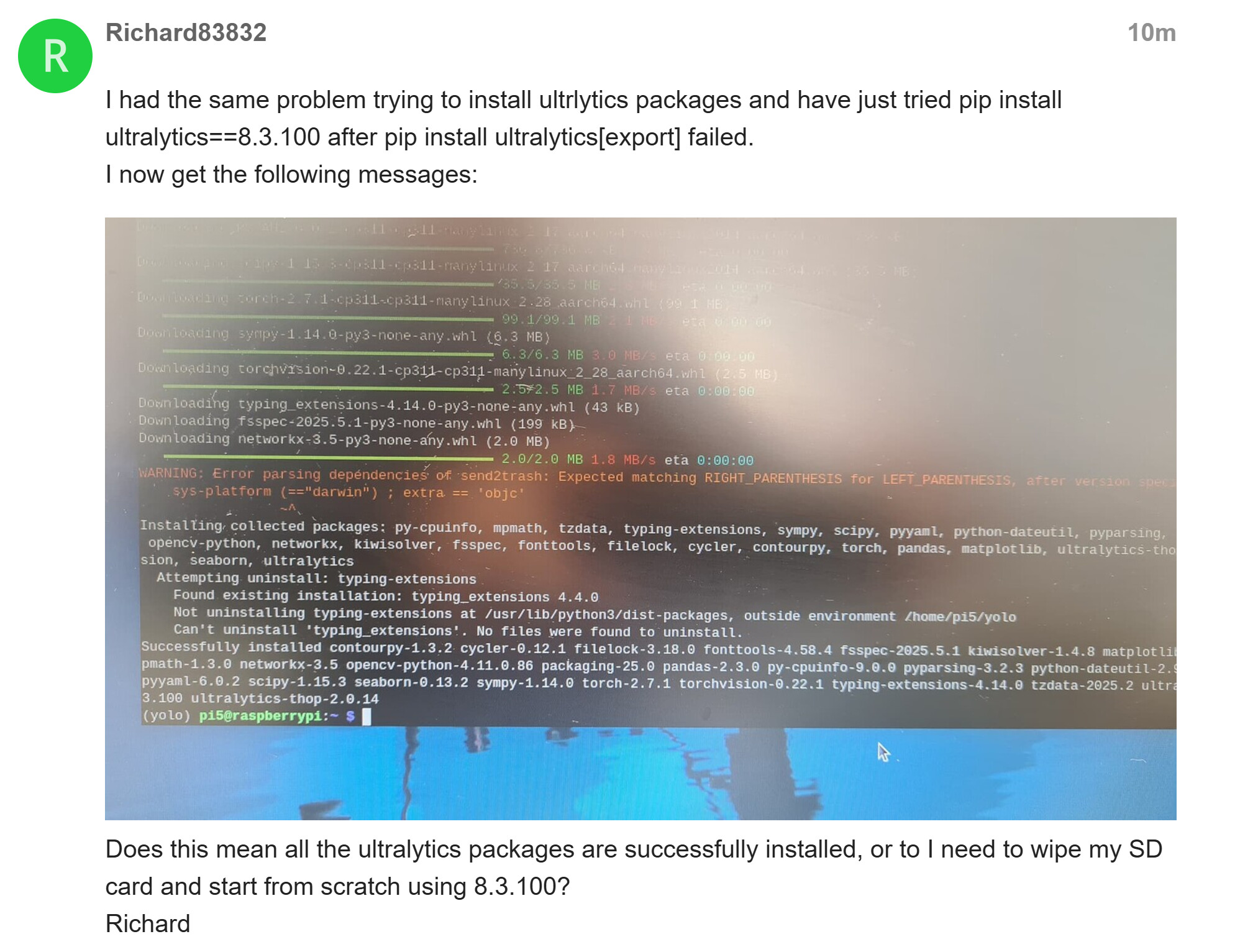

ok here goes
ran ‘pip install ultralytics==8.3.100’ and that worked until end with the following mysterious errors:-
Installing collected packages: numpy
Attempting uninstall: numpy
Found existing installation: numpy 1.23.5
Uninstalling numpy-1.23.5:
Successfully uninstalled numpy-1.23.5
ERROR: pip’s dependency resolver does not currently take into account all the packages that are installed. This behaviour is the source of the following dependency conflicts.
mobileclip 0.1.0 requires clip-benchmark>=1.4.0, which is not installed.
mobileclip 0.1.0 requires datasets>=2.21.0, which is not installed.
mediapipe 0.10.18 requires numpy<2, but you have numpy 2.1.1 which is incompatible.
tensorflow-cpu-aws 2.13.0 requires numpy<=1.24.3,>=1.22, but you have numpy 2.1.1 which is incompatible.
tensorflow-cpu-aws 2.13.0 requires typing-extensions<4.6.0,>=3.6.6, but you have typing-extensions 4.14.1 which is incompatible.
Successfully installed numpy-2.1.1
Got “ YOLOE Run Model.py” to work as expected, but tried it with the model ‘yoloe-11s-seg.onnx’

Upgrade pip, setuptools, and wheel first
pip install --upgrade pip setuptools wheel
Install ultralytics without [export] first
[export] brings in TensorFlow + JAX, which are huge and often problematic on ARM (like Pi). Most YOLO features work fine without them:
If you need export functionality, try forcing specific dependency versions instead of letting pip resolve infinitely. For example:
pip install ultralytics[export] --use-deprecated=legacy-resolver
Or pin dependencies step by step:
pip install "jax>=0.4.13,<0.5" "importlib_resources>=6.0.0,<6.5" tensorflow==2.15.0
