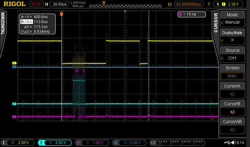

I am trying to use a new raspi 4 to talk with another microprocessor. I would like to use the SPI protocol to communicate. I am having issues with the spidev trans and trans2 functions when sending out simple values ( like number ascii in hex 0X31 ). With or without the wires connected to the microprocessor there is a second chip select pulse. I have tried looking at the raspi forums, and stackoverflow, but I can’t seem to find a solution. I have looked and searched in core electronic forums, and did not see anything there. I don’t want to use a “gpio pin” for the chip select due to the amount of time it takes for the pin to toggle on and off ( what should be 60usec for spi, turns into almost 115 usec with second pulse, which turns into 185 usec using a gpio pin).
