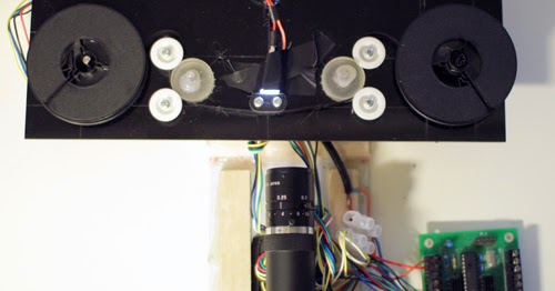

Telecine! Totally forgot that word:
https://hackaday.io/project/167426/instructions
Turning the spools with motors could damage the film. Be careful!

Nil - the result achieved is essentially what I have in mind, but my original thought was to use a RPi4B together with the newish HQ camera fitted with a macro lens. The trick will be to built a suitable film transport and camera support and synchronising camera trigger setup, but I have a few thoughts about that that I can try with my 3D printer. I appreciate the issue with tearing the film, my current Super 8 projector has managed to do that a few times already. The reason for the post was to ask if anyone knew what frame rate the RPi Zero could manage, doing the same thing. I would expect it is substantially less than the RPi4B but it might still be fine for what I am after.
Just noticed the second video - DIY film scanner. That’s essentially what I have in mind.

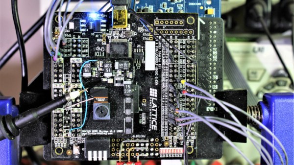

Glad to help a bit. Also this:
Thanks for the links nil - it’s given me a number of new ideas. The link to the high frame rate article is amazing. Seems that the sky’s the limit if you really need it (which I don’t). Cheers.
