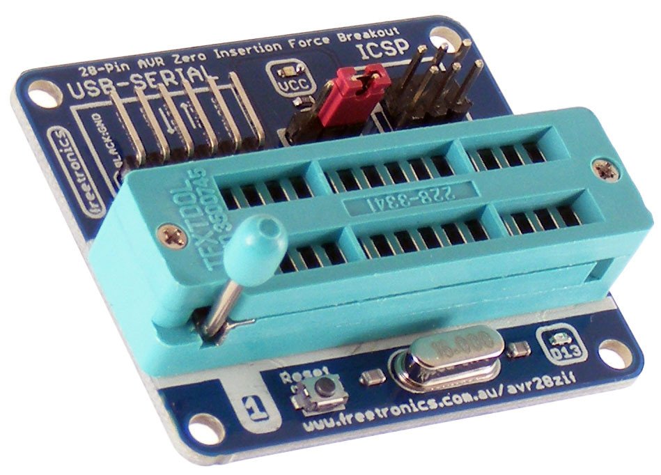

I would suggest programming the atmega8’s beforehand and testing them to rule out the possibility of an error on the PCB itself. One of these would be really handy:
You can add something to your sketch potentially that will blink the LED on this breakout when the board has been programmed, but doesn’t have any functionality in your PCB.
