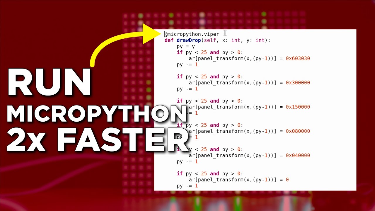

Hi Jeff,
Great list of options! One more that deserves some mention is Viper, a way of writing constrained functions in MicroPython that are a lot faster, as they compile to native machine code. @Brenton has a great explanation in his video on our GlowBit library for MicroPython:
@Pete56180 What sort of stuff would you rather run on C?
