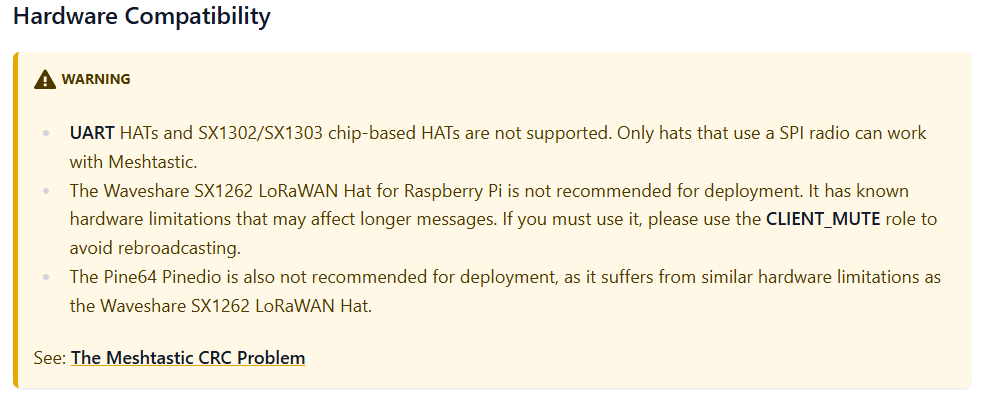

Are you trying to connect the LoRa Gateways into the Meshtastic network or having them seperate from the network? Because according to their website, SX1303 LoRa Gateways can’t be added into Meshtastic due to not possessing SPI Radio devices:

The SX1303 is a Semtech chip used typically in multi-channel LoRaWAN gateways (handling many LoRaWAN channels, etc.). Meshtastic is more of a single radio peer-to-peer / mesh protocol: nodes rebroadcast, etc.The docs clearly state that SPI radio hats are required. The SX1303 gateway HATs often use different architectures and are not typical “SPI radio” HATs in the sense Meshtastic expects. This is why the forum reply said SX1303 gateways can’t be added into Meshtastic in the normal way
