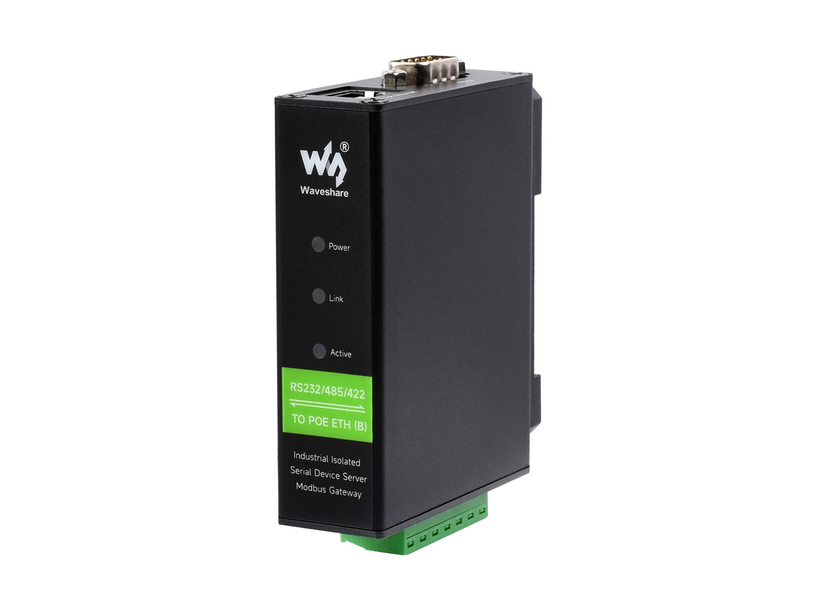

Read moreThe product image here is the Waveshare non-POE device (blue label, SKU 24962) however the part number is Waveshare SKU 24963 which would be the POE device (green label). Could I confirm which one you get if you order? It the POE device SKU 24963 I was after.

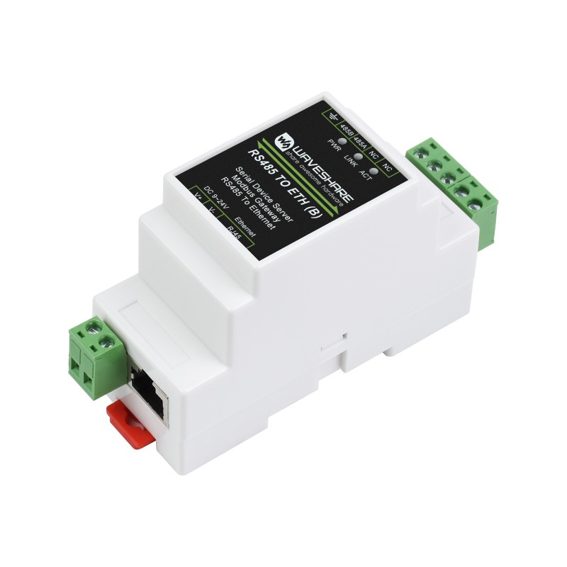

Unfortunately we do not have the POE version of this module, but we do have something similar in the form of:
Thanks @Jane the appeal of the WS-24963 was 2-channel RS-485 support in one PoE DIN package. You do also have this WS-23626 PoE module, and I could use two of these with two cables. The WS-30303 you suggested has better internal isolation, but would be 4-wide on the DIN bar to provide 2 channels. That for the info!
