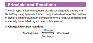

Just adding my 2c on this too in case anyone reads this in future :slightly_smiling_face:
Our CR2032 is definitely NOT rechargeable similarly with some of the other Lithium Manganese Dioxide based cells, there are a few reasons for this. Even being lithium manganese dioxide, the battery is surprisingly stable and likely won’t explode which is a good thing, but if you look at the mechanics of how the exchange of electronics within the various electrochemical reactions in detail, you’ll notice that you need to charge the battery extremely slowly in order to avoid causing the cell to fail (this will still have an effect on its total lifespan but as Jeff said, if the rechargeable versions are charged in-situ such as in an RTC very slowly that’s one of the only practical reasons to try and determine a way to charge this kind of cell)
https://biz.maxell.com/en/rechargeable_batteries/ML_17e.pdf
Picking up a replacement when they run dead and correctly disposing of the original is almost always the best option here. Particularly given they’re quite inexpensive.
