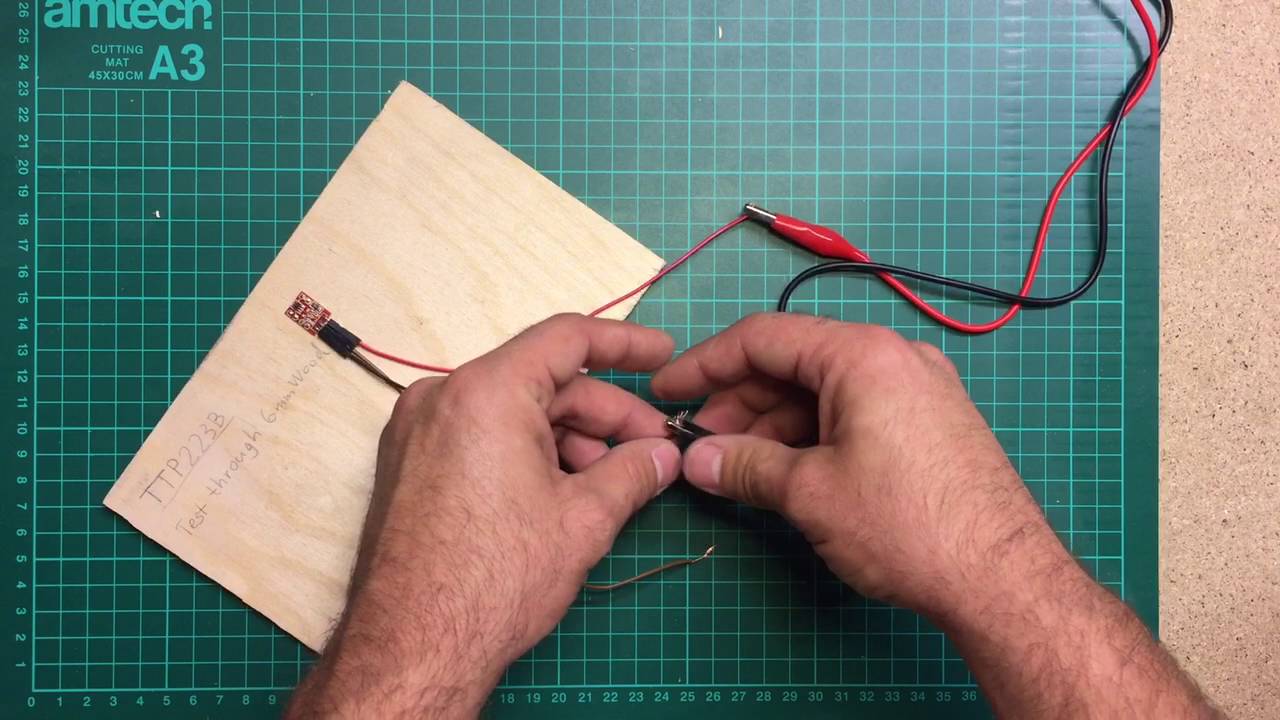

You can certainly detect touch through wood using capacitive sensors as long as it’s not too thick there’s a few bedside clocks that use this trick to detect when you rest your hand on top to display the time. Here’s a clip of someone using a TP223 quite easily through some 6mm ply and a link to both a sensor and a link to another forum from Arduino describing the best options for your project to detect touch capacitively through wood (you may need to flatten some of the pins on the bottom of the sensor to get a decent connection with a nail file or similar). If there’s anything else that we can help you with please let us know!

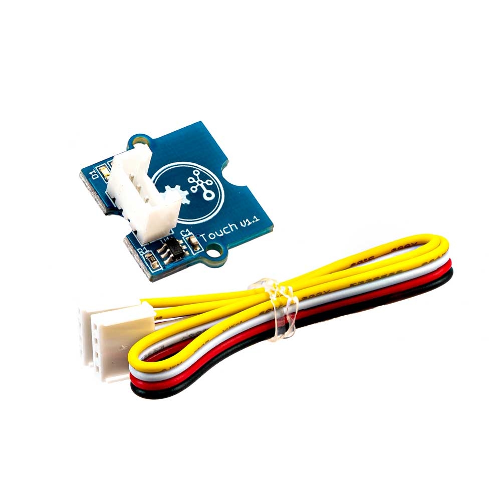

Hi Bryce, I did have a look at that. I was concerned about the specific spot based capacitive sensing. For sensing over the whole plywood, would I require multiple sensors? Plus I used the TP223 Grove sensor but it’s causing a bit of an issue since the surface for sensing is essentially curved.
