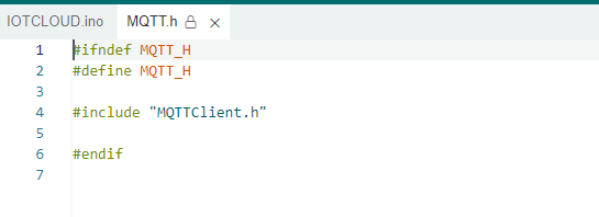

If you left click on
#include <MQTT.h>
and select go to definition does it take you to the header file? If not there may have been an issue when downloading the library.
I had no idea you could do this! Great tip!
thanks jack it takes me here
Hi Theo,
It looks like you may have installed a different library package to the one used in the guide,
Within the repo that you found the code, there is a file containing all of the libraries used to make those examples.
i.e. your MQTT libraries folder should be esp-mqtt
Liam
