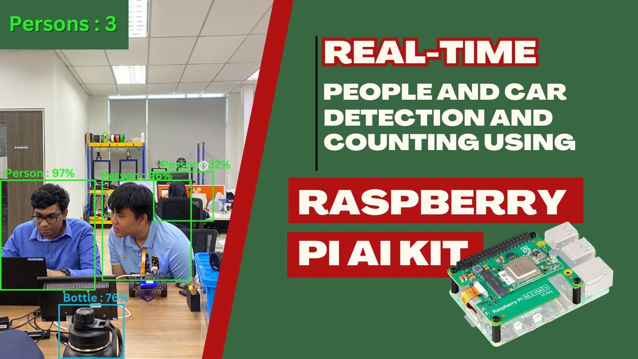

That being said, you would be amazed by some of the capabilities of the new AI products from Raspberry Pi when paired with vision algorithms like YOLO and AI modules like Hailo.
See the below videos for some examples of people counting:
(These are two random guides I’ve found that somewhat visualise real-time object counting.)
Looking specifically at the 2nd video’s crosswalk demonstration. It performs relatively well considering the number of people that are largely obfuscated from the camera at any given time. I imagine, given a clear view of all potatoes on the line (such as a birds-eye view), a model trained on your potatoes would produce a result with high relative accuracy.
