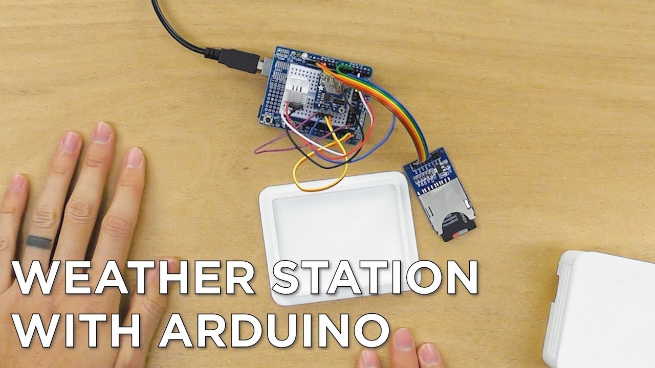

I originally found you via this older video
