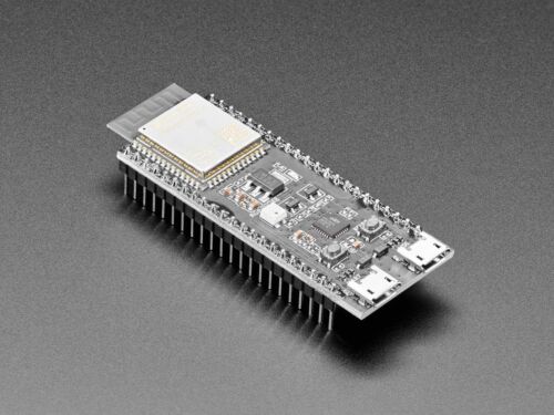

ESP32­-S3­-DevKitC-1 - ESP32-S3-WROOM-2 - 32MB Flash 8MB PSRAM (ADA5364)
This is a placeholder topic for “ESP32­-S3­-DevKitC-1 - ESP32-S3-WROOM-2 - 32MB Flash 8MB PSRAM” comments.
The ESP32-S3-DevKitC-1 is an entry-level development board equipped with ESP32-S3-WROOM-2, a general-purpose Wi-Fi + Bluetooth LE MCU module that…
