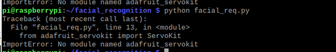

Heya Tim, I do need you a favor please.
I’m trying to link between the facial recognition and the adafruit servokit by replacing the “gpizero import AngularServo” according to your code.
And when I ran the program, it said No module named Adafruit_servokit.
So, I do need you advice how can I solve it, please.
Thank you in advance Tim
