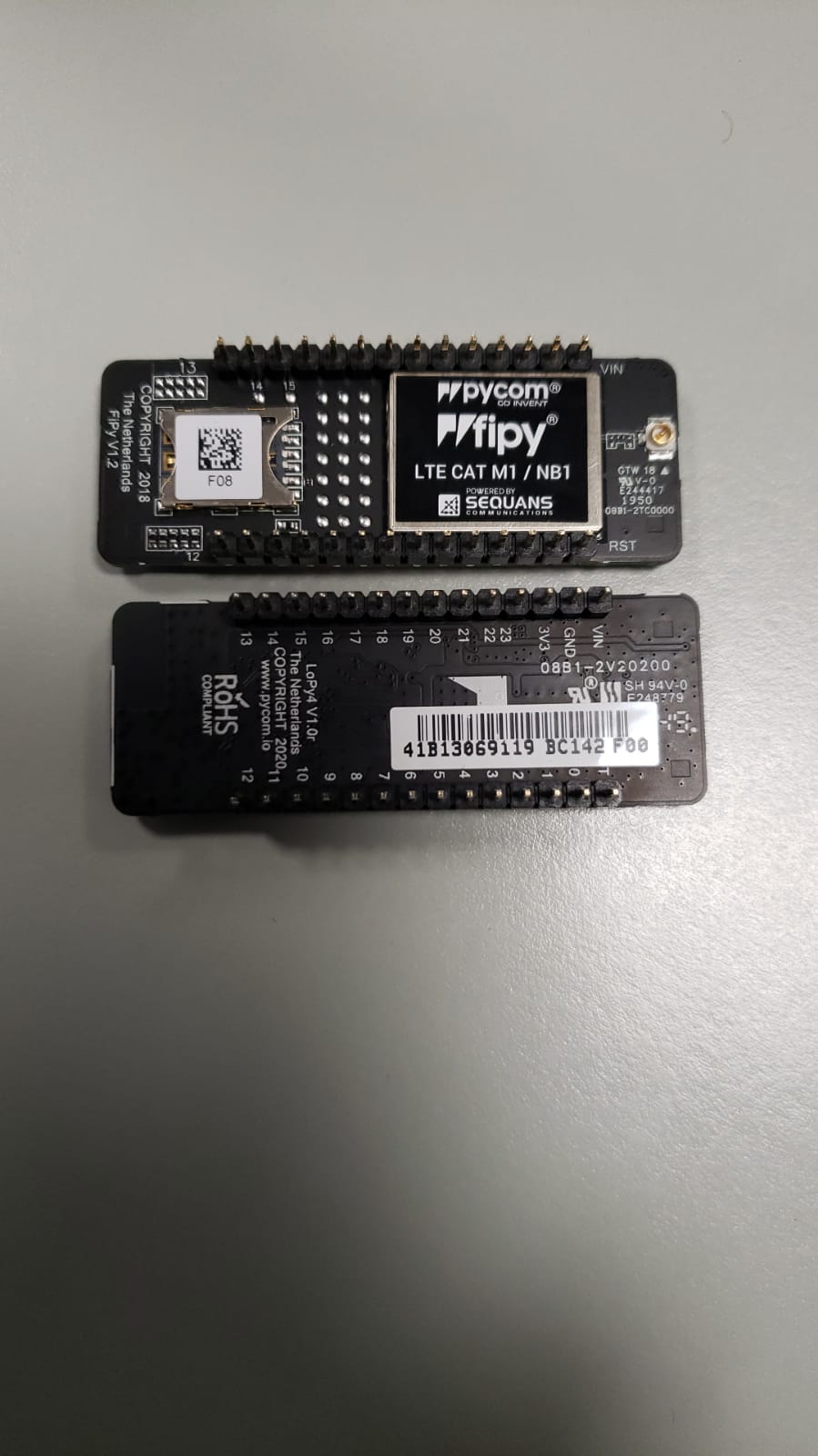

As per the specification, during deep sleep both FiPy and LoPy4 should consume around 15 Microamperes (uA) but I am not getting current in Microamperes.
Fipy with expansion board is consuming 32.81 Milliampere (mA) and lopy4 with expansion board is consuming 38 Milliampere (mA) during deep sleep.
Why it is not working in deep sleep as per specification.
