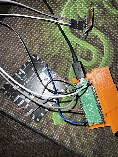

Not exactly the same as the glowbit 8x8 audio visualiser tutorial but I thought it should work
Also I seem to now have problem with the glowbit 8x8 in that it’s now not showing all the leds …testing it with matrix.wheel

Hi Robin,
It’s either a software problem where for some reason your Pico isn’t talking to LEDs above that index, or it could be a hardware fault, where one LED has failed, and therefore isn’t lighting up or passing on the data to the next one in the chain like it should.
Have you tried the basic code in the setup guide to eliminate any chance of errors in the rest of the code?
Let us know how you go, if it looks like a hardware fault we’ll handle the rest via email.
Yes I have tried the basic code. That where I took the pic from
Robin
Hi Robin,
Looks like this may be a hardware fault then, shoot us an email to the address on our contact page, and we’ll sort you out:
