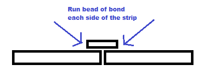

Without knowing your project and desire, one robust way to help with rough cuts would be to lay a strip over the join and glue that. then you have a smooth face to face and not cut edge to edge. (I have a CO2 laser so had nice clean edges for my last project)
it will look a bit more industrial, but should be stronger and better sealed
Useful trick … however I’m gluing sides onto a box so won’t help me this time :frowning:
