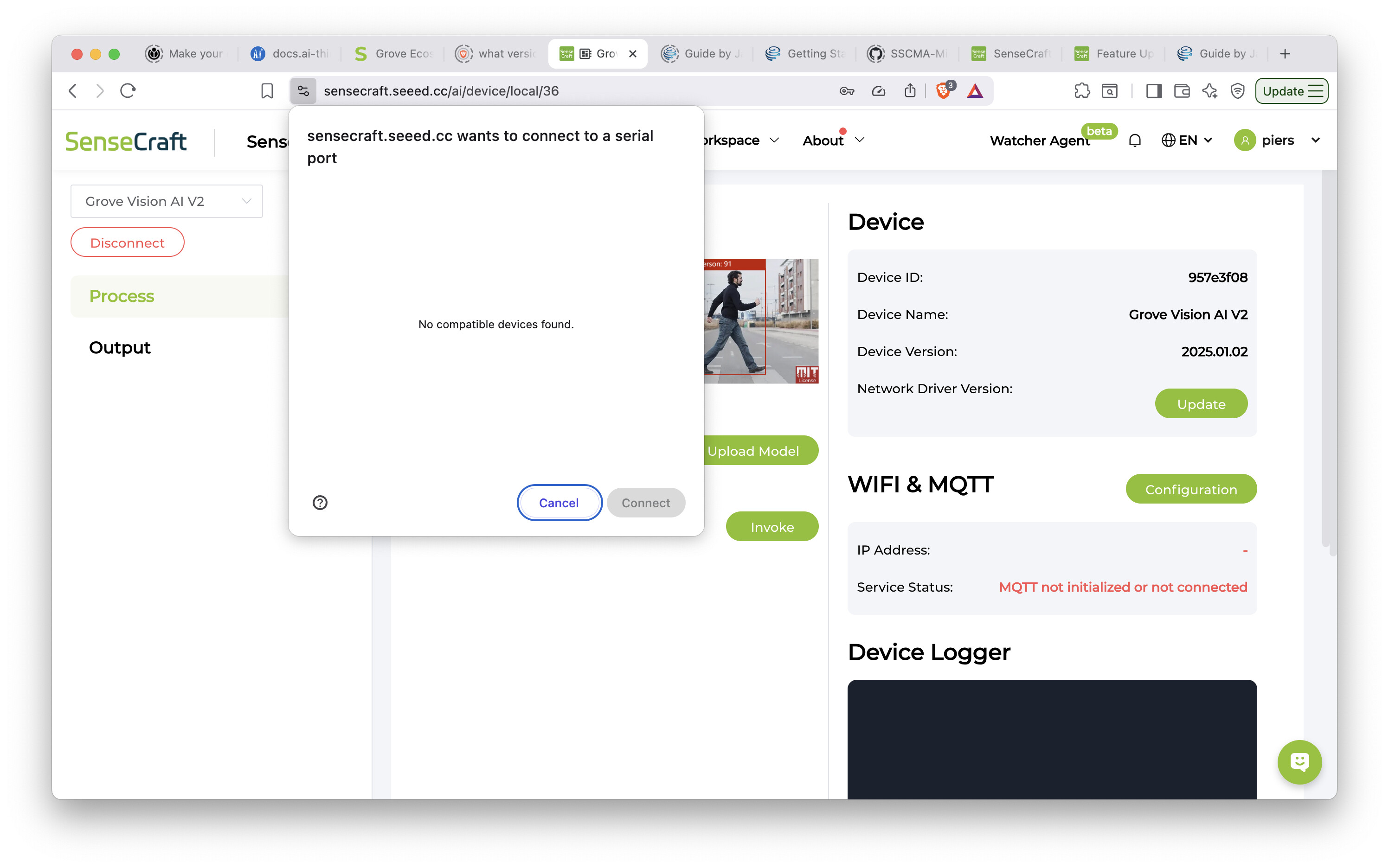

I’d like to upgrade the firmware on the Grove board but the website is demanding a serial port and a ESP32 board, and I haven’t yet plucked up the courage to do a build from scratch from the repo. Am I missing something because everything else seems so easy? and

Are you definitely on the SenseCraft Studio? In the top left, you should be able to select your Grove device to connect to. From there, you should just be able to hit the update firmware button without doing any building. Let us know where you have issues here.

See attached screenshots for the upgrade issue: it seems to want me to be hooked up to ESP32 rather than directly.

Hello, thought I’d post the solution since I’ve since found it.
As the message on the screen indicates, you need a Xiao ESP32 to upgrade the firmware. These come with (separate) header pins so hooking them up to the Grove is a doddle. Just follow the on-screen instructions and it takes about a minute.
