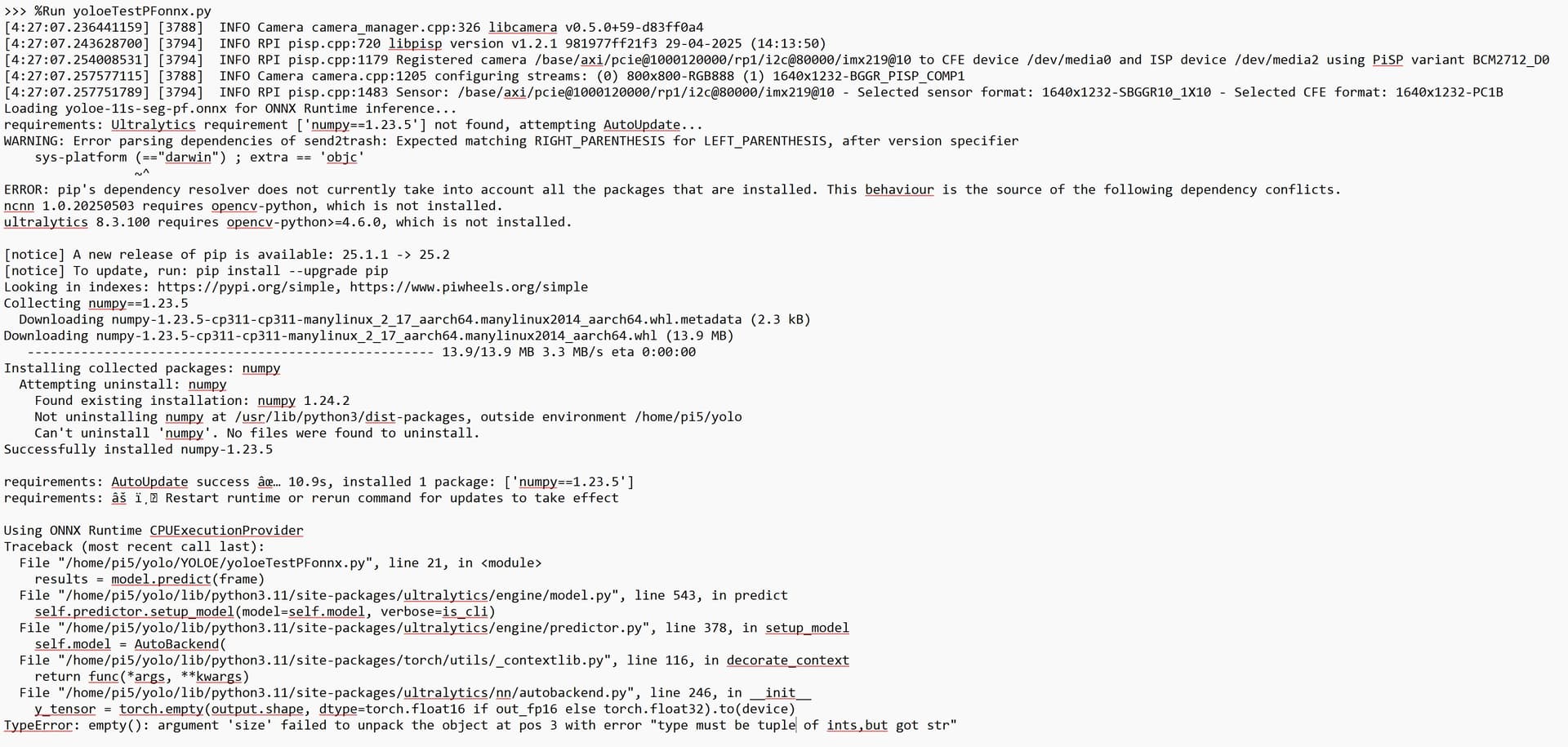

Following your advice, I attempted to convert it to ONNX format using your Prompt-Free ONNX Conversion.py (see attached yoloeTestPFonnx.py), but this code resulted in the attached error message.
I don’t want to take more of your time on trying to increase the YOLOE FPS as it’s unlikely to meet my requirement for real time tracking at >20 FPS. Your tutorials have all been excellent, and I hoping to achieve my helmet mounted camera tracking objectives by other means. I would be keen to exchange ideas with anybody else who is interested in real time camera tracking using computer vision or any other means such as GPS, UWB etc.
Hey @Richard83832,
I am sceptical that you could get 20fps out of YOLOE on the Pi and it being useful for your use case. To attain that FPS, you would need to lower the processing resolution quite a bit, and this would lower the detection range quite a bit. So possible to get close to that FPS, but the detection range might not be suitable - depends what you are doing.
As for that error, did you follow our standard YOLO guide then try to get YOLOE going with it? If so it would create an error like that. We have a more robust installation guide that solves the issues you are seeing there, that you might wanna check out.
In terms of getting 20fps on a YOLO model, the standard YOLO11n model could get that with better performance (just not the deteciton capabilities of YOLOE). You would need to lower the resolution a tad still, but in the guide you were following we convert it to the NCNN format which REALLY speeds things up.
