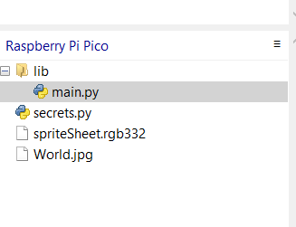

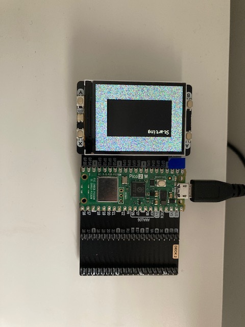

on the pico display 2 i do get a black display coming up and text saying starting in the corner but nothing loads.
i have added the files to my pico
not sure if they look correct in pic

I have taken a pic of how i have secrests set up with my lon and lat removing my ssid an password details and attached to this i have also attached a pic of the screen i receive on my display pack and the error it throws up on when i run main script, i can connect to wifi through it as proven with below test, thanks very much for help so far from the community :slight_smile:

I did notice on the display, a message pops up saying lat and lon briefly before disappearing and showing just a black screen.
Many thanks
okay just realised World.jpg should be all lower case so changed it and main now runs without throwing up any errors however i am still on getting the starting text on black background as shown in above pic.
[Errno2] ENOENT is a file access problem - the file doesn’t exist, the path is wrong, the file permission is not correct or something similar. Line 90 in method showMap() is
j.open_file("world.jpg")
so the problem is associated with finding or opening that file. Make sure that “world.jpg” exists, is at the default file access location for the script and has the permissions necessary to allow access from your script.
