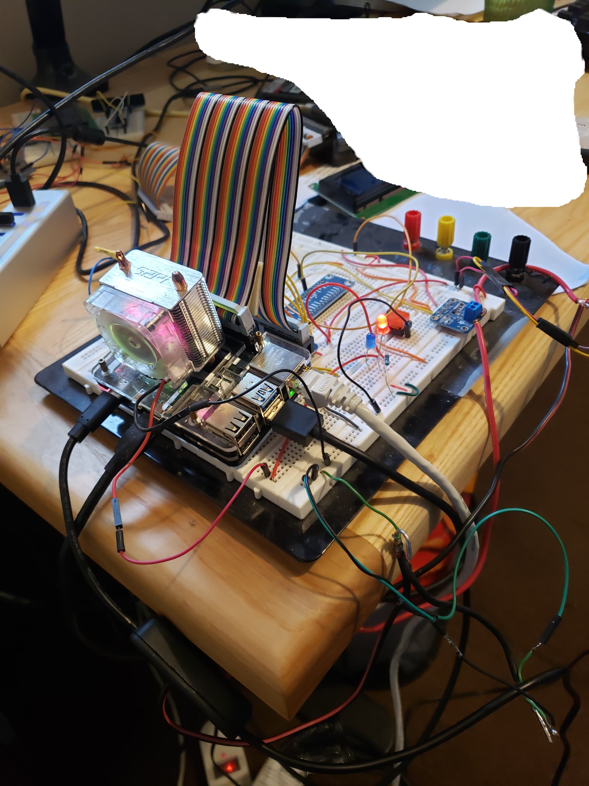

I have a Pi4 on a big breadboard and a 15 watt power supply.
Take note that the Pi4 is open to ambient room temperature. See photo.
The graph results show that the FAN unplugged forces the temperature to rise to over 60 C.
Then when I start the FAN, the temperature settled at about 50C.
My /boot/config.txt contains:
over_voltage=6
arm_freq=1800
temp_soft_limit=77
I added A Heat Sink With Fan
And after butchering the power supply cable so that I could monitor Voltage drops and Current with a Adafruit INA219 i2c board I see that when Temperature is at 50 C I measure:
Voltage (VIN+) : 5.161 V
Voltage (VIN-) : 5.012 V
Shunt Voltage : 0.14867 V
Shunt Current : 1.4867 A
Power Calc. : 7.45134 W
Power Register : 7.452 W

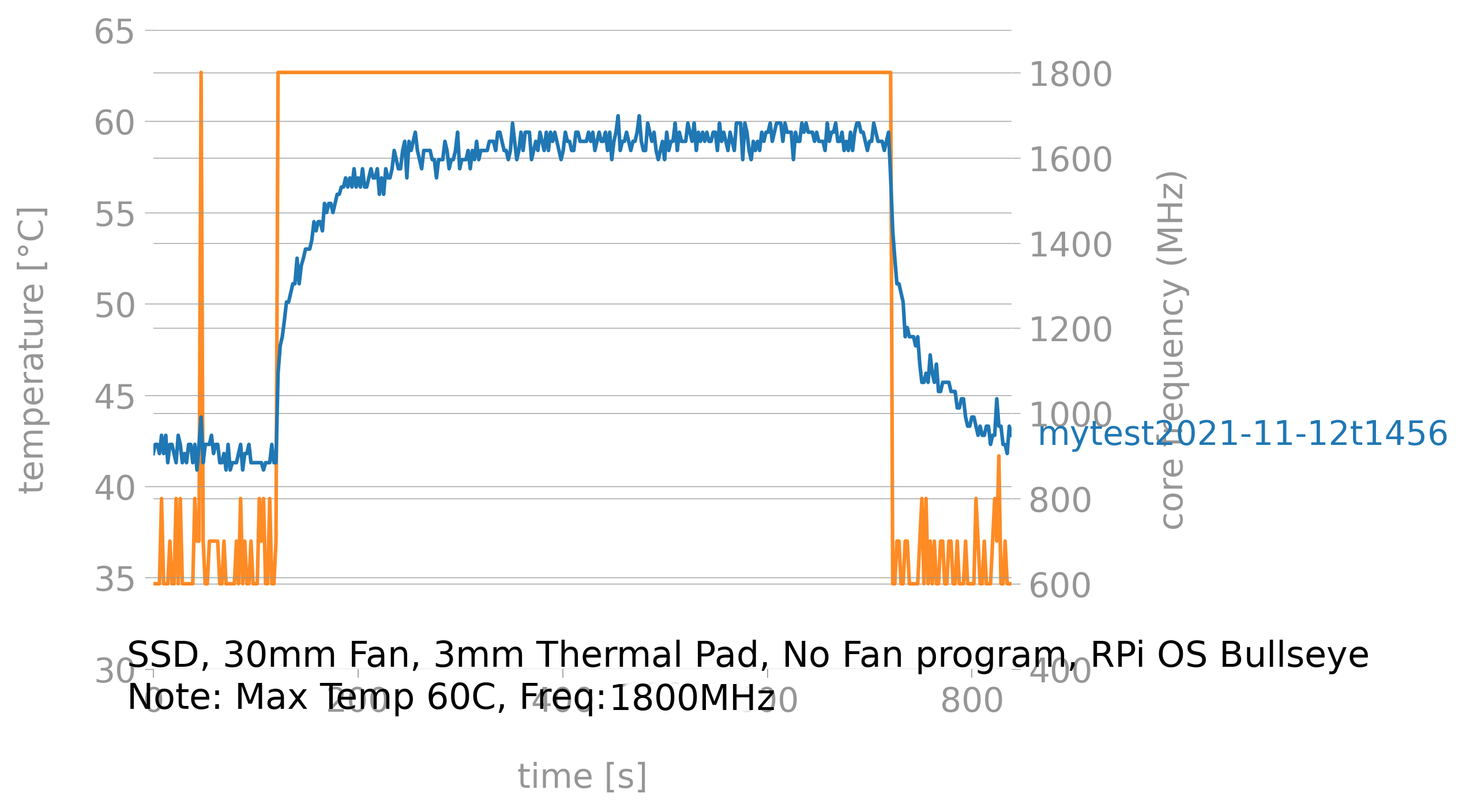

Anyway, the results of my stressberry test.
I had to modify the export code a bit to fit in the top of the CPU freq graph.
MPLBACKEND=Agg stressberry-plot mytest.out -f -d 300 -f -l 400 2000 -t 30 60 -o mytest.png --not-transparent
The actual benchmark code wasn’t changed, apart from the path:
stressberry-run -n "My Test" -d 1800 -i 300 -c 4 mytest.out

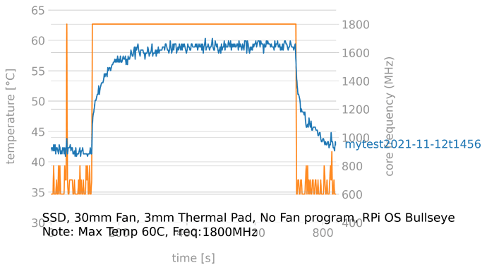

Update on my Pi4 with the OS Bullseye installed with before graph for comparison.
Previous OS Buster in the latest PI4 cooling configuration:
Fresh install of Bullseye OS, same cooling configuration:
1800MHz increased the temperature by about 6C.
Nice data Graham! Great to see a realword comparison and to see the impact of the extra clock speed

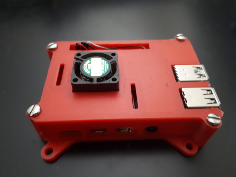

That’s a nice looking print! Case came out well, and it’s cool to see the fan doing its job on the temperature plot.
