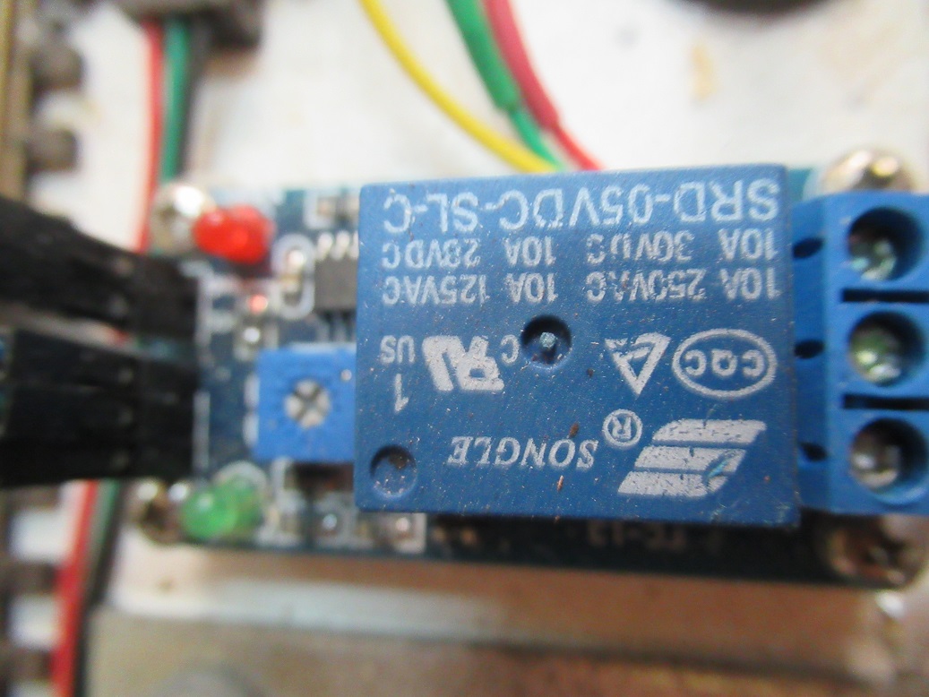

I have taken pics of my train set relays that I have been using. I looked at the numbers on the relay I already have, and the one i bought had the same numbers.
My relay board in place has 5 pins on one end of it.
Which do different functions.
3 pins connect to the sensor unit I have ( see pics) and 2 are a power source connection to put power int the relay.
The new one I bought has only got 3 pins on the end, and I do not know if these will work the sensors.
I also bought a new sound board car from JCar, which I was hoping to connect my sensors nd the relay to the sound board to make them operate.
As this is a new field for me, and I am not trained in electronics,
I would appreciate all th ehelp you can give me.
I am attaching the pics I have taken of all my products, That I hope to run on my model train set.
If these one are not correct, please let me know which ones I should be buying, to make the system work, if possible.
more pics next post
Regards
Wayne Douglas
president of Turntable Model Train Club
Sorry, can’t understand. How is the IR sensor module and relay module connected together? Is there a microcontroller in between?

With the parts you have now
It looks like the sensor and relay module work as a pair, typically the sensors (sometimes going by the name of a ‘IR detection’ sensor).
I couldn’t find too much in the way of ‘nice’ to use IR sensors locally but something like this combined with a microcontroller(programming required) would be needed to set everything up which isn’t the same as the ones you have: RedBot Sensor - Line Follower | Sparkfun SEN-11769 | Core Electronics Australia
The relay modules from Core are great for using with a microcontroller, and while they feature the same relay that you have the underlying circuitry to drive them isn’t the same.
