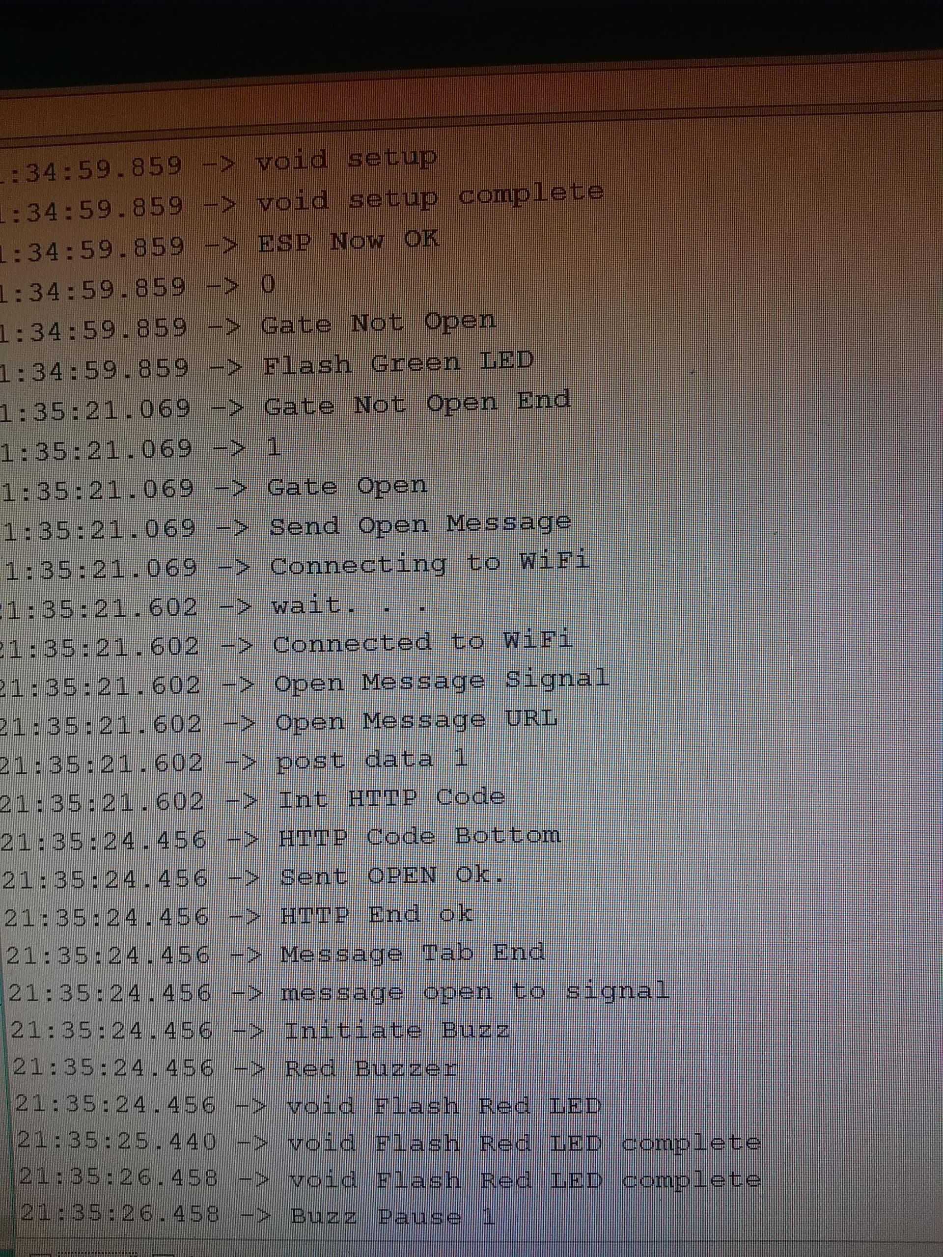

That listing reveals a lot, but not perhaps what you expect. Why does the text “void Flash Red LED complete” occur twice, one second apart? There is only one statement that does that print: the second line should not be there. That suggests either that there is a memory fault, or that memory is getting corrupted. If I had to guess (and it’s only a guess) I would say that the send_message_open() call is triggering a response that is getting processed at OnDataRecv() (that takes one second) and something is going stupid at that point. You need debug statements in OnDataRecv() to see what was received and how it updates myData. You might need to write a little routine to print out all of incomingData in hex.
The Red LED flashes hi/lo every 100ms during an alarm state. The void Flash Red LED complete shows the end of that process.

Yes, but the number of times it occurs depends on duration (which you should be printing in the debug message) and in any case not with a 1 second delay between messages. Something is happening between that first and second message that is causing a long delay and which does not have any debug messages. Probably the state of GateOpen is changing, and causing the delay loop to pause for longer than the delay specified, and that means that OnDataRecv must have fired, so that’s where you need to be looking. If that’s working OK then I suspect the problem is that second delay function is never returning because of the value of GateOpen when it is called. However that doesn’t explain how that last debug message can print, which is why I suspect corruption. You need many more debug messages in that area, and you need to be printing the values of relevant variables along with each message.
