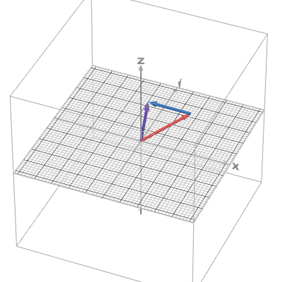

Here I use an arduino library to extract a vector.
From there you want to finding the heading unit vector (i, j) to figure out which way is forward.
Then you call the angle of the z vector AGAINST that i+j vector.
