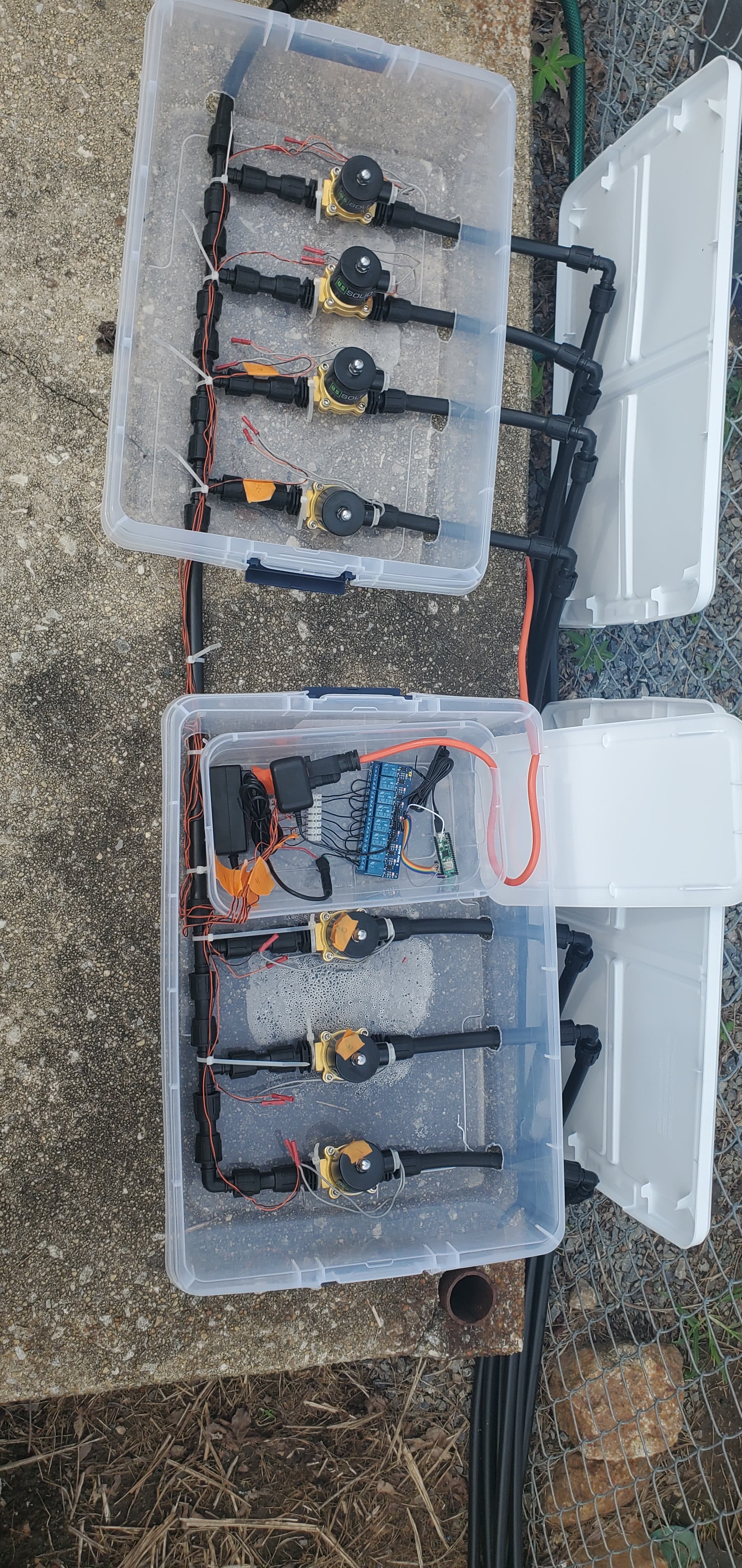

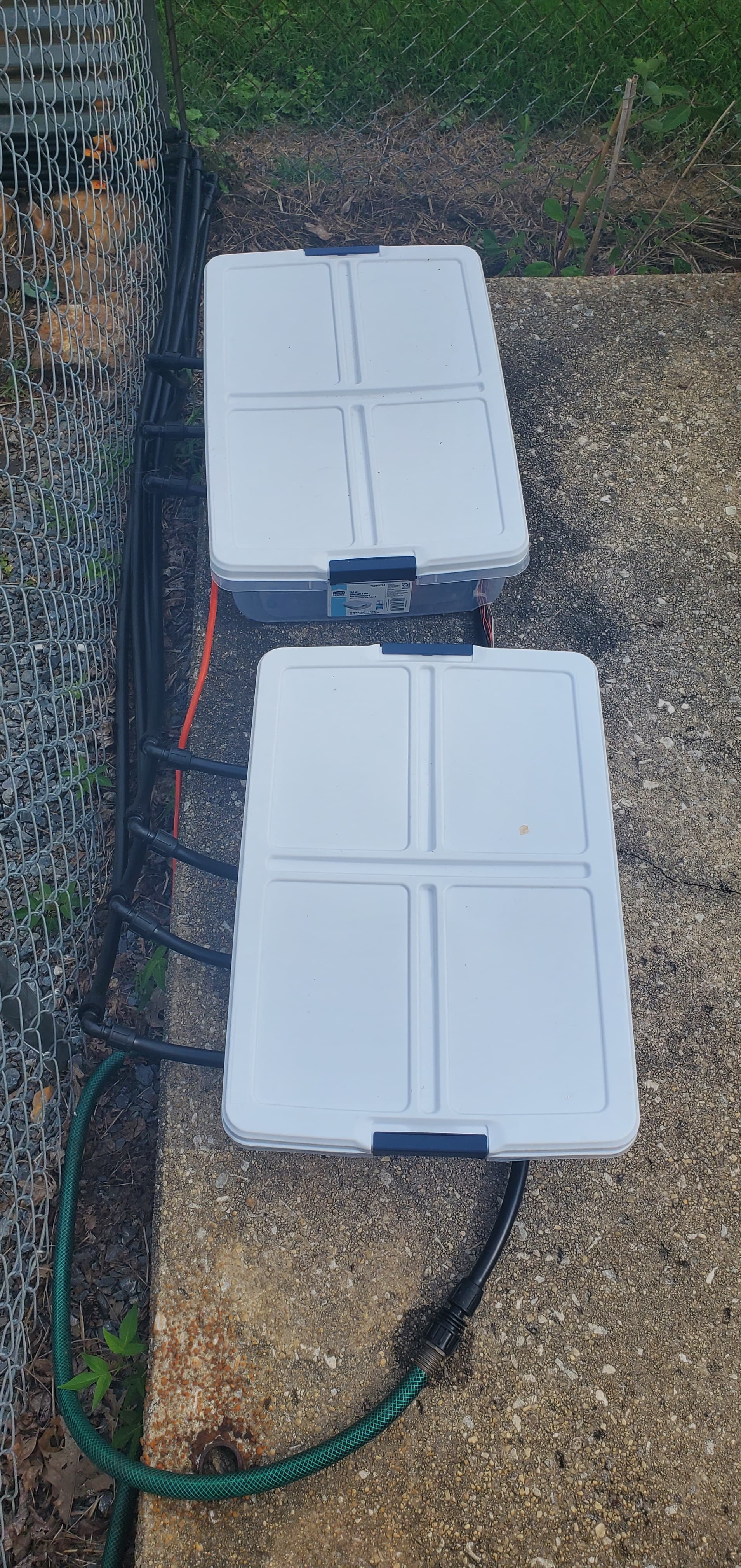

Oh wow! Thank you so much!!! This is super helpful. I will be spending some time this weekend trying to get everything up and running.
Hey @Eric289745
No worries at all, hopefully you found some success with the project :slight_smile:
It took much longer than I was hoping and I plan to make a full post on the project, but I finally got the watering system hooked up and working! Again, such a huge thanks for getting me started!!! It would have taken so much longer without the bones of the interface you provided.
I did end up making some changes to the interface, like setting the schedule time individually for each bed and limiting the number of valves open at once to 2 (limited by water pressure and the power supply for the solenoid valves). I also spent quite a bit of time trying to get AJAX to work for updating timer values and things but it seems like you cant actually run javascript on the pico (if I am wrong please let me know though!). The page wont automatically update and have the desired behavoirs so I just turn off a valve thats already off to reload for the time being :slightly_smiling_face:. Here is my final working code though:

I may add multiple waterings per day at some point, and I really want to add a weather forecast check and automatically pause if rain is in the forecast, but for now it serves its purpose.
@Eric289745
Great setup and project!
Always good to see a project taken all the way and finished nicely, getting the project to work in the field is always the hard part!
