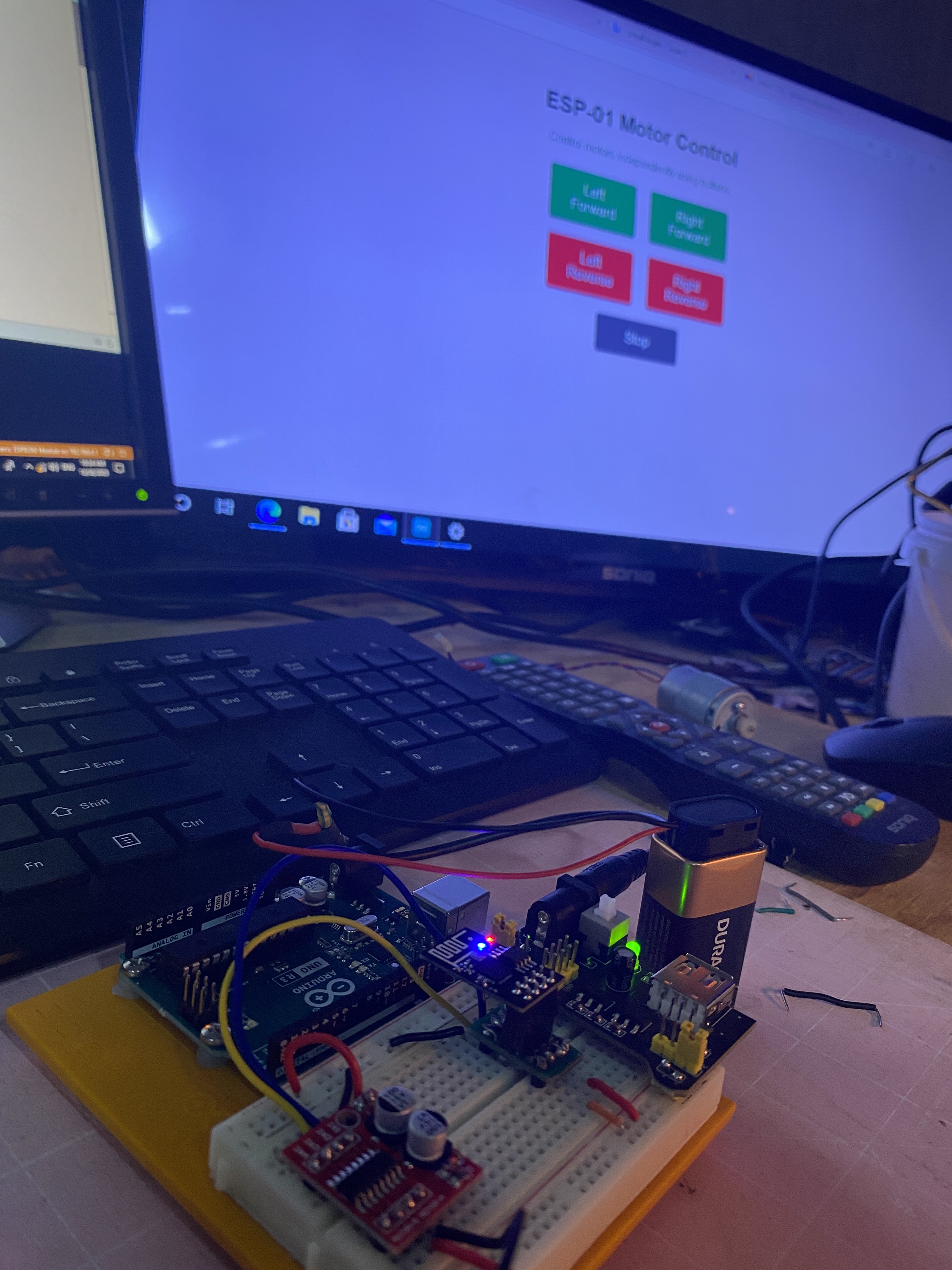

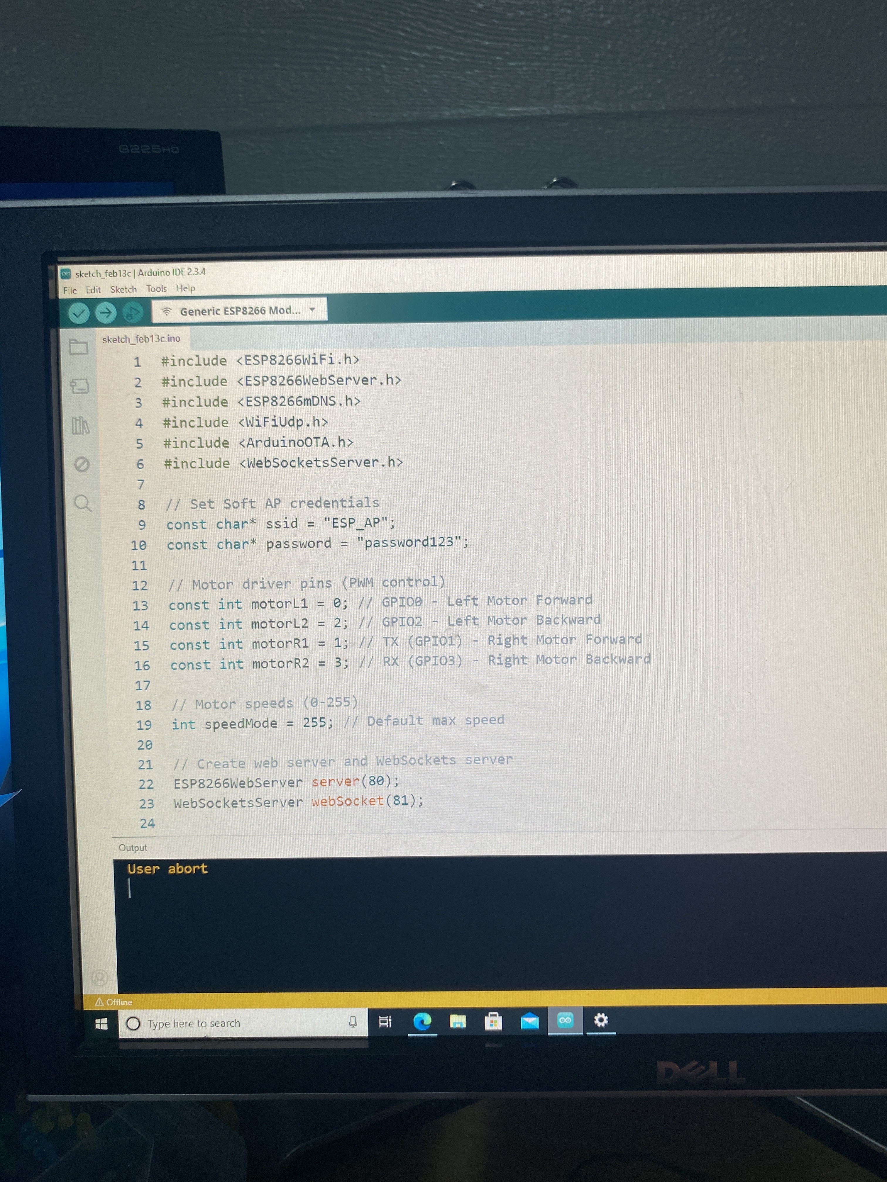

I got this working, soft access with wifi uploads for programming, this frees up all GPIO pins to control the motors.
https://www.instagram.com/electrictronic_zootopia?igsh=MWZvYjVkcmdyYno3aA%3D%3D&utm_source=qr
If you want to see video of it working
Hey @Josh286640,
Glad to see you got it working! Can’t use Instagram right now, but I’ll be checking it out once I can!
It’s cool as, I haven’t found anyone else on the net who’s doing this with the Esp01 everyone thinks you only have 2 usable pins. Gota think outside the box. Once it’s flashed with the wifi ota program and that’s kept in every code after, we get 4 usable pins, just need to make sure the ota code is maintained or you get a board that can’t be reprogrammed.
