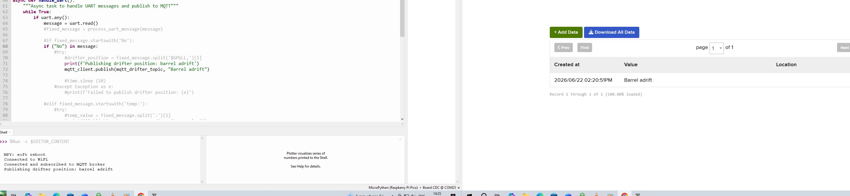

This shows the desired result when a normal Meshtastic Message is sent containing the No trigger
The Detection Sensor transmission No does not trigger

Thanks Jane,
Sorry about the slow response, but my Drifter project got mangled by a boat propellor, so I had some hardware to rebuild including the underwater housing
I put those lines, you gave me, into the program but unfortunately it doesnt show the message generated by the Detection sensor. If I type in a message on the same device with the same “friendly name” (Drifter detected) it works and your print(repr(message)) displays and triggers a mqtt publication
MPY: soft reboot
Connected to WiFi
Connected and subscribed to MQTT broker
Publishing drifter position: barrel adrift
b’\r\n2c30: Drifter\r\n’
The sensor detection message is received and displayed in messages but will not work as a trigger
