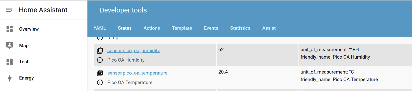

Fixed.
I needed to add the unique_id for each sensor in the configuration.yaml file. Restarted HA and I can see the values.
# Loads default set of integrations. Do not remove.
default_config:
# Load frontend themes from the themes folder
frontend:
  themes: !include_dir_merge_named themes
automation: !include automations.yaml
script: !include scripts.yaml
scene: !include scenes.yaml
mqtt:
  sensor:
    - name: "Pico OA Temperature"
      unique_id: "pico_oa_temperature"
      state_topic: "home/mqtt_ws"
      unit_of_measurement: "°C"
      value_template: "{{ value_json.temp }}" # Note the spaces.
    - name: "Pico OA Humidity"
      unique_id: "pico_oa_humidity"
      unit_of_measurement: "%RH"
      value_template: "{{ value_json.rh }}"  # Note the spaces.
