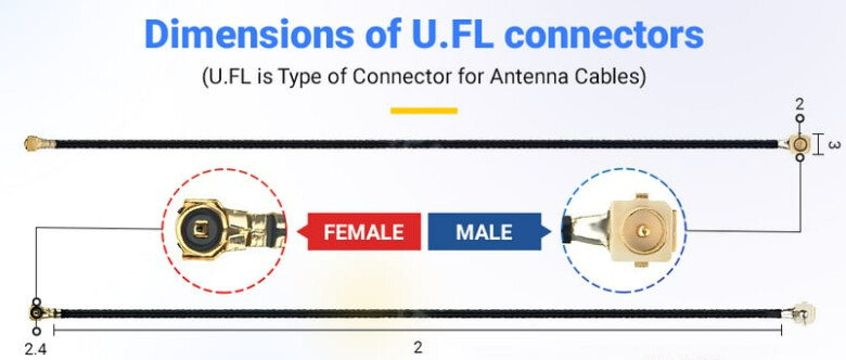

Hey Donald,
I had to grab this off the shelf to check, but it’s definitely a Female U.FL SMT connector. It’s used across a wide range of the industry.
A helpful diagram I have in my notes:
The other end, as Bob said, is Female SMA connector.

Hi Bob,
There might be a misunderstanding.
The picture I posted is of the U.FL connectors. It’s for clearly distinguishing between male and female U.FL connectors. No SMA ends at all in this photo. I was posting it in case it helps someone else in the future.
I do agree that the lack of clear photos of the connectors and a lack of specs on the web page is a problem. I’ll go ahead and update the page with some more information and clearer photos.
Also, a small correction, SMA end is actually a RP SMA Female connector. My mistake.
