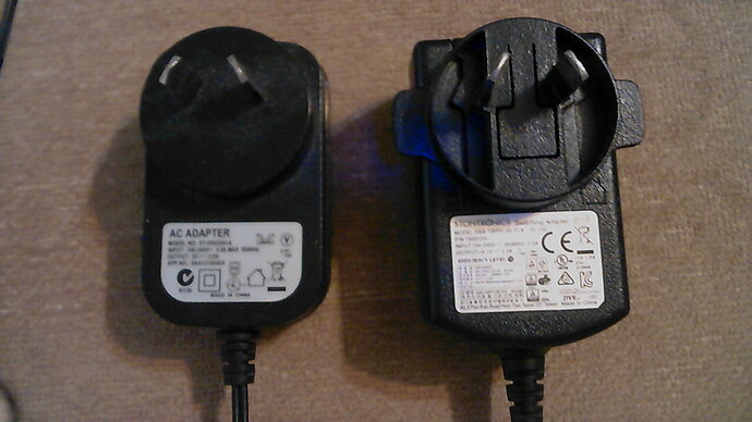

Sometimes if I need a wider gap on my power board, I find a double adapter like this is quite handy:
The one on the right looks like (from a distance) a proper RPI 5.1V PSU, so it should be fine. The first thing I do with my RPI PSU’s of that type is grab a pair of pliers and snap the sides off
Besides, you don’t truly own something until you void the warranty!
