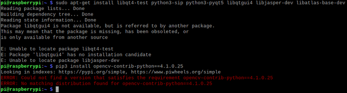

Hello first of all thank you for this tutorial however when I am installing the plugin needed I have an error
I am using bullseye-arm64-full.img.xz
Do you have any idea how I can resolve this issue?

Hey @Jeffry275889, welcome to the forums!
Unfortunately, OPEN-CV is not currently fully compatible with the newer Bullseye OS and this is likely contributing to this issue you are encountering.
For the moment we recommend flashing and using the previous Raspberry Pi ‘Buster’ OS on your Micro-SD for use with the Real Time Scanning and Storing QR Codes With Raspberry Pi and OpenCV guide.
Official ‘Buster’ Image Download Link Here
We have an update on this issue at the top of the guide and will be sure to update it in the future when this issue is resolved.
Hope this helps! :grinning:
