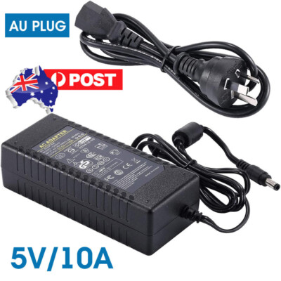

There’s a handful of similar options but these are generally also out of stock and/or look pretty shonky:
Is there a technical reason why it’s so difficult to find a 5V 10A power supply?

Unfortunately in AU, the electrical and product restrictions make it hard to source a beefy IEC brick, If you do decide to go down the “shonky” pathway, you can always cut the wires, crimp some ferrules and screw those down in the terminals.
Typically those DC jack adapters have smaller wire inside, typical ratings are between 3-5A -
