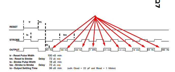

You could use something like this, which is a nifty little chip:
Which outputs a digital signal with pulse lengths that represent the amplitude of each band (by default, 63Hz, 160Hz, 400Hz, 1kHz, 2.5kHz, 6.25kHz and 16kHz). Here are a couple of pictures from the datasheet:
