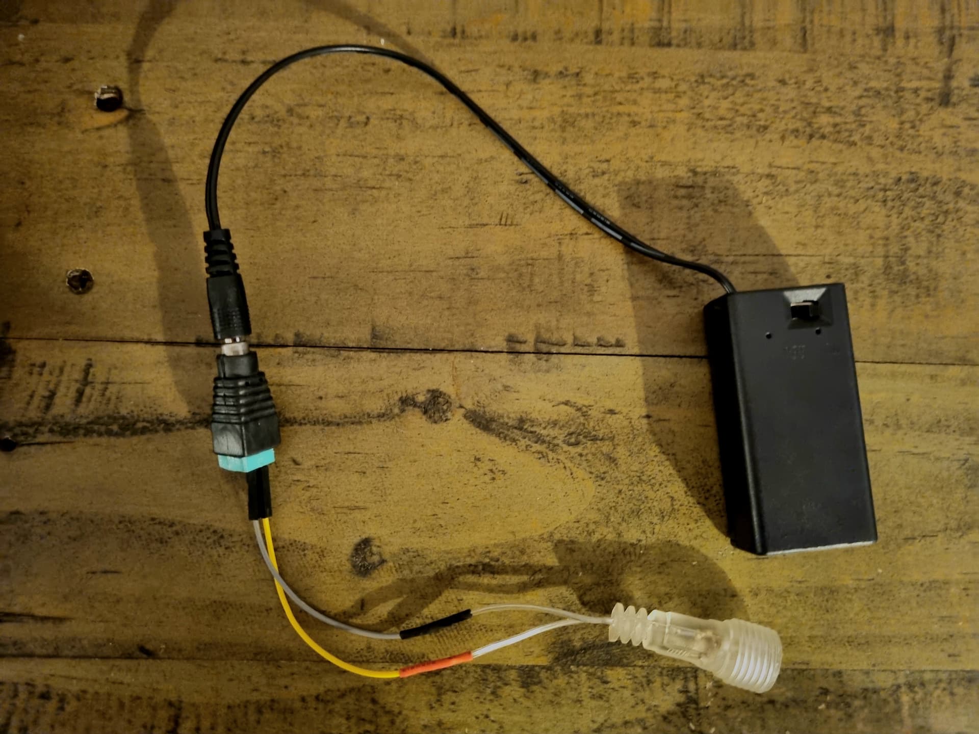

Just tying this one up.
I looked into a lot of waterproof systems but the problem I couldn’t solve is where can I put the cable such that it would be a tripping hazard.
In the end, I what worked great was just a good ol’ 9v battery. Way brighter.
Current draw on the hole thing was about 250ma so a 9v Battery should get me 4 hours of light.
That’s not super impressive but it’s actually all I need, I’m not out there all the time and a 9v battery is easy to plug in and take out.
So for now here is my excellent design.
And I’ll probably upgrade to a barrel jack.
Nothing is more rainproof than taking the power supply back indoor when you’re done with it :man_shrugging: :umbrella: .

Looks very tidy!
How has this been working for you? Has 4 hours of battery life been sufficient?
I’ve used it twice now. Once last night where we were out there for dusk which was like 30 minutes.
Another time I was experimenting and it maintained it’s brightness for 2 hours I think.
Same battery both runs.
Before I purchased the setup depicted above I was using a breadboard to connect the battery to the lights, a multi-meter in the middle, and it was all a bit messy. I’ll probably get out there more now that I have a more robust solution :slight_smile:
