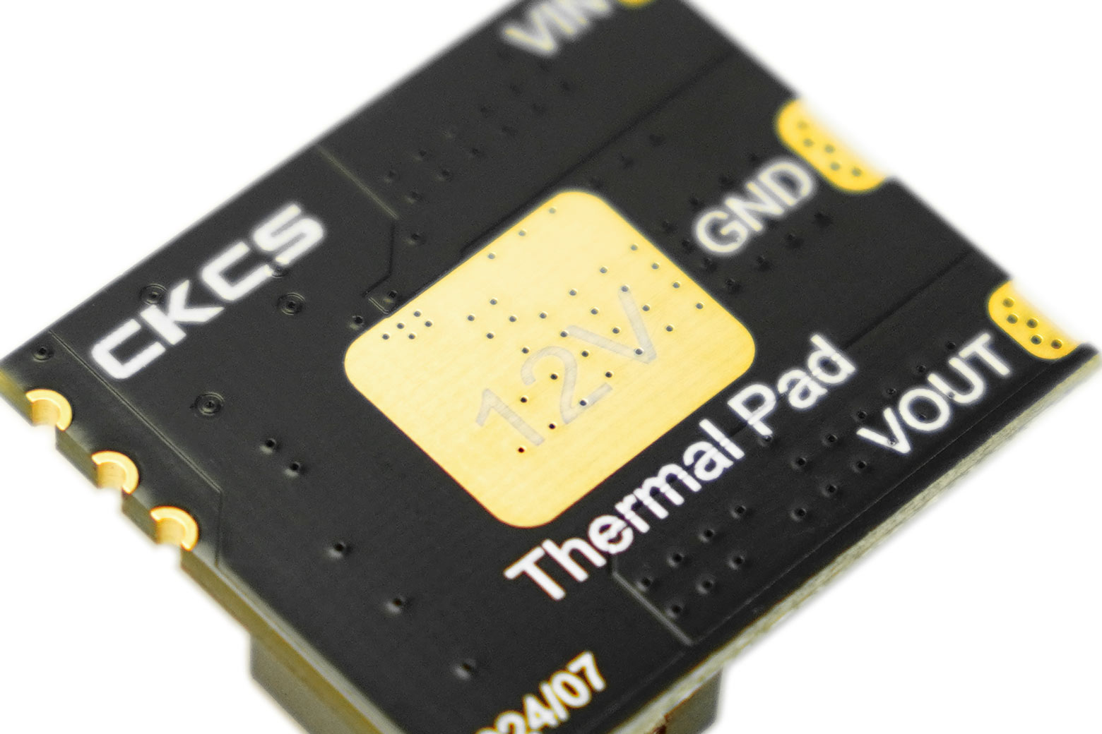

I’m after a step down buck regulator to reduce from 18v power tool battery to 12v-10a.
I want to pull the regulator inside an old battery charger so size is a issue.
Could someone recommend the best buck regulator. I am looking at the
DC-DC Step Down Buck Converter (15~24V to 12V/12A)

Hey there, @Graham317900, and welcome to the forum. Glad to have you here.
This would be the right sort of module if you were going to be doing this work, buuuuut
I’d want to confirm your battery details and chemistry before saying if this would be a good match. Could you provide a couple more details of your battery?
I’d also say that while it’s theoretically fine, at 12 V10 A, that’s going to get hot, especially in a cramped charging enclosure so you’re really going to want to make certain you’re dissipating that heat correctly. This unit has a thermal pad and I’d recommend you use it.
