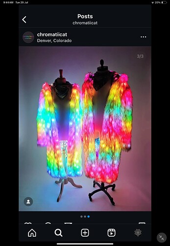

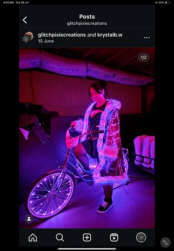

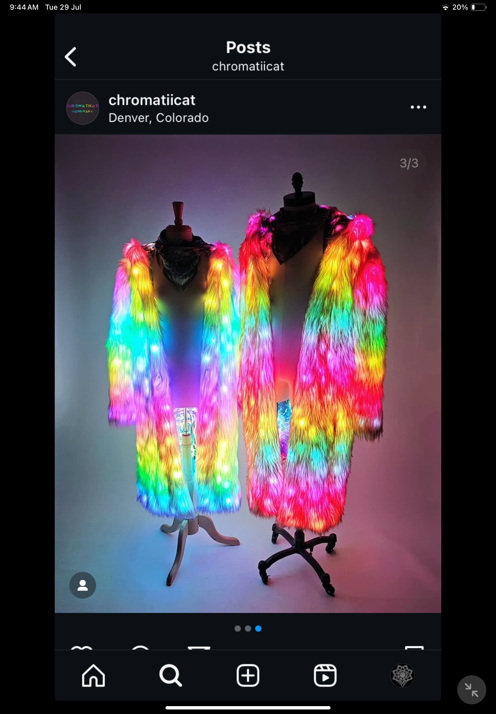

I’m just hoping for a bit of assistance upgrading my current set up please.
I currently make wearable LED coats, very rudimentary set up and I’m looking to upgrade the way I’m building them, if you are able to send me in the right direction for information or products I could look into.
These are the coats I currently make, can you please recommend some of your products to get a similar effect.
I’m looking at possibly upgrading to a setup like this but I’m unsure of the components used.

Nice work on the coats, they look great! Jeff raises some really valid points too. Keen to hear more about your current setup so folks can help suggest the best upgrade path.
If you’re exploring more dynamic lighting (like animations or colour shifts), addressable LEDs might be a great next step. Core Electronics has a range of those here:

the leds in the coats in your examples might not be strips but addressable fairy lights cause they are more spaced out something like Adafruit NeoPixel LED Dots Strand - 20 LEDs at 2 Pitch | Buy in Australia | ADA3630 | Core Electronics though there are lots of other options…
