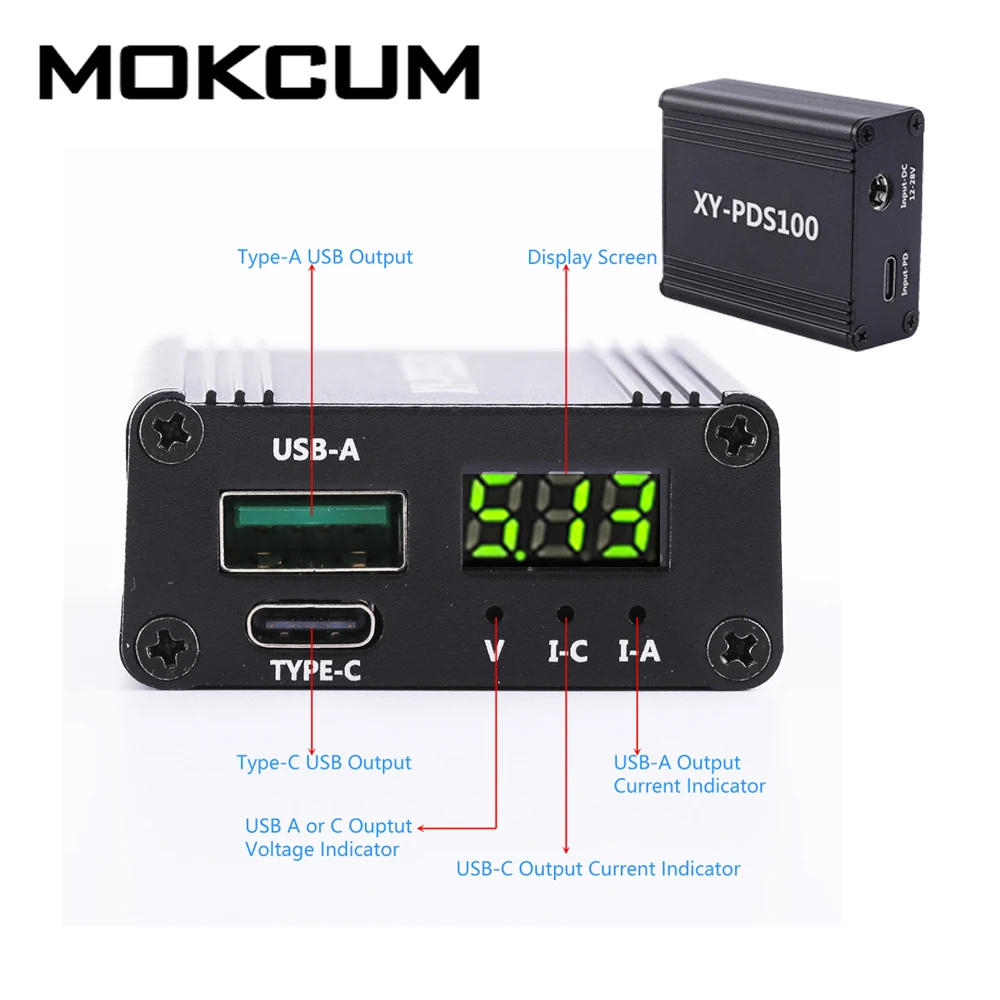

So the powerbanks that I am hoping to run, have an input at 9v @2A as the fastest charging option. This is what I was hoping to be able to provide it, however, that is over USB-C and will need to be tricked into outputting that amount.
There’s an aliexpress box that does this:
that can output 100W over USB-C but I was hoping for something more compact and more affordable.
(I know that it cant output 100w if the input isnt sufficient)
So Ideally, yes, a USB PD device is what I want, but not a decoy trigger, they turn USB-C into a specific voltage, I want to turn a specific voltage INTO USB-PD.
I might have the solution though, a 12v Car USB-C adapter with PD. I can then wire up a few of them and use that.
