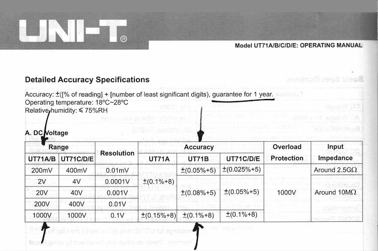

For your information.
This is the DC spec for my newest (and most expensive) DMM. It is nearly 10 yrs old now and I have never had the calibration checked so I would not be able to guarantee the accuracy. One of the important figures is the + number for the least significant digit correction. When you get to AC voltage this number increases to 40 you could pretty well ignore the last 2 digits. And this is for a fairly good quality meter. These figures should be published for all meters but unfortunately rarely are to this level of completeness.
Uni-T publish for all measuring functions in the handbook.
I also have a uni-T clamp meter which gets down to milliamps and is surprisingly accurate when the wire is in the centre and current the right direction.
Cheers Bob
