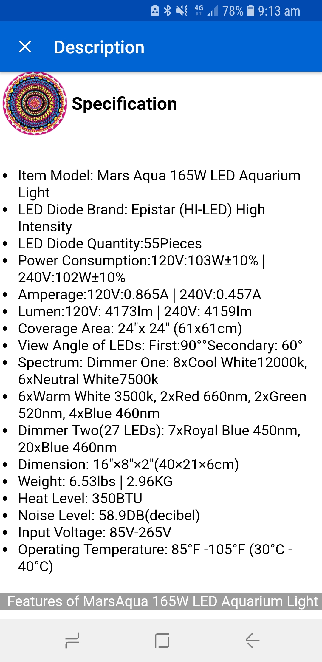

Ive screenshotted the specifications of the light. Hopefully it uploads.

Thanks for that info. Hmm, this might be a bit out of my league as I was hoping there was something like a dimmer “input” (such as a connector, or terminal block) that you could send pulses to (which is how these things normally work).
If there are dials (either rotary encoders or potentiometers) already installed, then it might turn into more of a hack than a integration. Given 240V is in use, it might be dangerous as well.
Perhaps the manufacturer can help - maybe contact whom you bought it from and ask for their recommendations to control the dimmer automatically?
